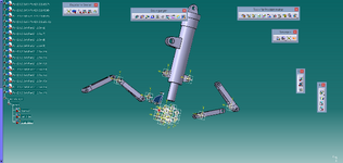

Greetings, I have a question, when I hide just some parts, and after showing them it also shows the whole vertical and horizontal Axes, how can I hide them?
Kind regards
Looking at the attached picture, the H and V axis are actually Sketches that are not hidden. And the white squares are Planes.
Since there are quite a few of both, I suggest using the Edit + Search to find and select all the Sketches, and then Hide/Show them. And repeat to find and select all the Planes.
