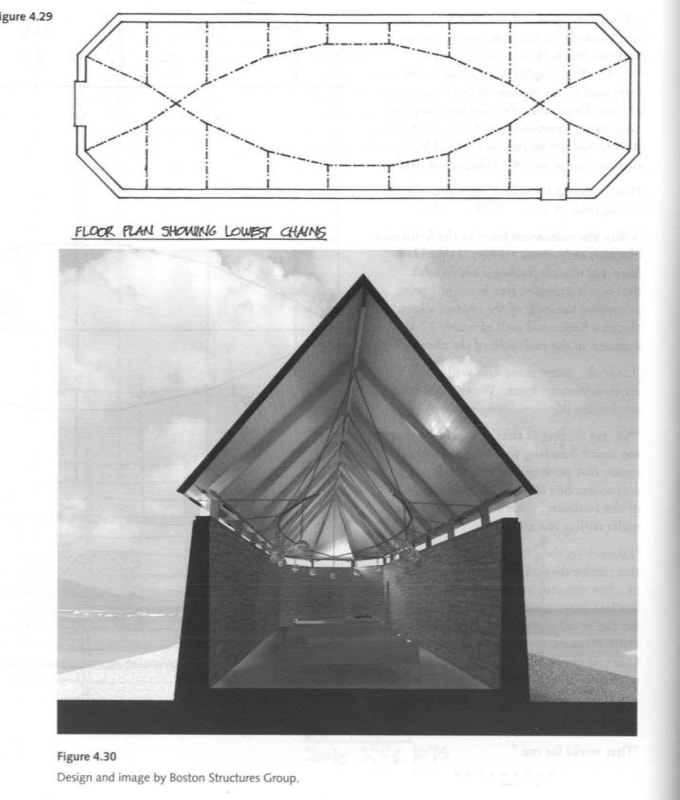

Can you design the top of the wall like (or reinforce it with) a horizontal beam?
steveh49 - That roof looks cool. I'd sure like to know how the anchor those curved rods....
I'm with Dhengr. Grab you calculator. Determine the thrust load. Apply that to the wall top plate and figure out how to make it span horizontally. It ain't going to go too far without some steel integrated into it or some cross ties that have been previously suggested. The building code is not intended to help us through these types of problems - the laws of physics are.
Houseboy, it doesn't exist. It's from a hypothetical conversation between engineer and architect about how designs can evolve. The building started rectangular, with those chamfers (in plan) introduced to anchor the chains. No detail discussed, just enough to note it's something that needs to be addressed.
