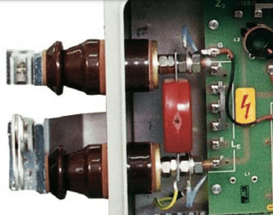

The carrier circuit has a ground switch in the CCVT and there is normally one in the line tuner as well. The carrier protection obviously has to be taken out but the line doesn't have to be taken out...assuming the utility allows work in CVT terminal box when line is energized. There are normally spark gaps across the CVT drain coil and on the input of the line tuner.
I have not heard about any spark gap issues in pilot carrier schemes. Are you taking about this:
