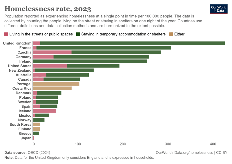

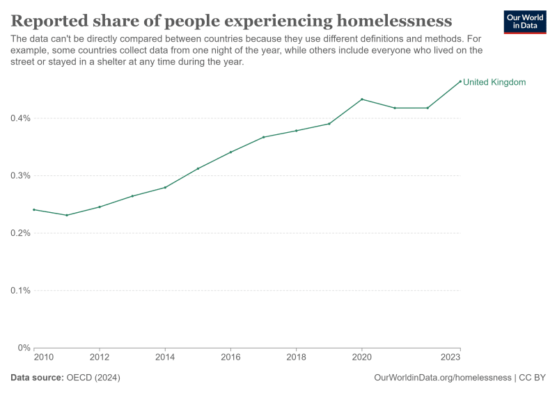

The UK has the greatest number of homeless people in the Western world.
sorry, the UK has more homeless people than the US ? or Brazil ?? If so, that's got to be created (IMHO) by definitions and data collection.
"Wir hoffen, dass dieses Mal alles gut gehen wird!"
My error... based on per capita...
It's a growth industry...
As usual Mr Irrelevant per capita thread drift derails the thread. Is it so hard to start a new thread?
I suggest you find the definition of rent seeker. - it has little to do with housing, especially in the context of this thread. I also suggest you look at the pink, homeless, not green, living in a non traditional dwelling. Many of the latter are illegal immigrants awaiting visa determination.

There is a lot here in definitions of "homelessness" which most would think of as the pink bit.
In total nos that's about 280,000. My guess is about 70,000 of that or maybe more are asylum seekers, but yes, there are lots of people priced out of accommodation due to decades of not enough social housing been built / sold off by the state and then councils not allowed to re-build using that money. So it helped those who could buy, but has taken 20-30 years to work its way through into not enough homes available. Won't be fixed even in 10 years is my guess or at all unless people sacrifice land deemed "greenbelt". Building new houses is now at least a major priority for the new government, but its no easy fix.
