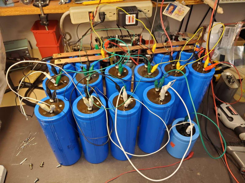

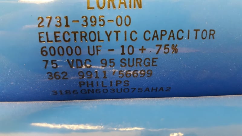

The Pyle I believe. Pyle is a good company. It will only be 12V rated and you will be paying the leakage price.
The other one claiming "Digital Hybrid", no.
This cap party: I have them up to 0nly 30V so far. It is amazing, you can see the forming happening. If I raise the bank 5V it takes about 60 seconds then the current limit drops off and the bank draws 5mA for about 5 minutes slowly dropping down to about 2mA. Over an hour or so it drops to under 1mA. Cranking up the voltage another 5V and it all repeats.
I'm hoping none of the alligator clips pop off. I also wear safety glasses and think thru any connections in my mind twice before physically carrying it out. 2,400 Joules at 75V..

I'm using a bench lab supply on a shelf above. It has two 50V channels. When I get to 50V I'll series them to get up to 70V. I might dash them up to 90V for as short as it takes if I'm feeling especially reckless at some point.
