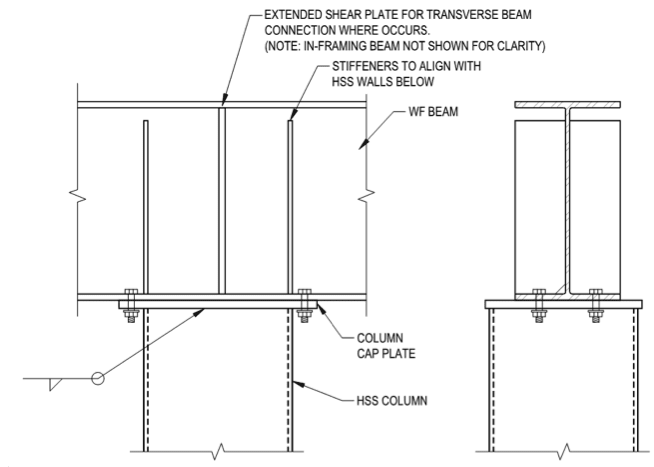

Dear Engineers,
Is cap plate moment connection allowed in Intermediate or Special SLRS?
The codes only discuss Moment End Plate connection when talking about beam to column connection.
Figure is taken from the internet.
Intermediate and Special moment frames require pre-qualified connections that have been tested and proven to provide the required performance. The easiest way to satisfy the requirement is to pick a pre-qualified connection from AISC 358. You are also allowed to do project-specific testing, but this will rarely be the economical choice.

@HTURKAK, but it's not a prequalified connection. We have sheds where we want to use moment-resisting cap plates where applicable (when rafter or beams run over wind-columns or others). What is the logic behind it being permissible to use, pls share your thoughts?
This is a bolted end plate moment connection, just turned 90 degrees. Right?
However, because one of the members is an HSS, this would not be a pre-qualified connection suitable for SMF.
That being said, it could certainly be an OMF. I believe the connection is covered in one of the examples from the AISC design guide on HSS connections. The example may not be EXACTLY the same connection, but I think it's pretty close.
Agree with JoshPlumSE. If your structure is only a one story shed, it seems like you could probably get an Ordinary frame to work and not need to deal with Intermediate or Special requirements.
Well, the section i am dealing with is not an SHS. it's an I section (Rafter).
Regarding the usage of OMRF for a single storied structure, our Code has used a lot of resources from AISC, ASCE etc, however it didn't include the sections where OMF had been permitted for single storied and some other low height structures. So we are kind of resorting to use either IMF or SMF as suitable when SDC becomes SDC D. We can use OMF in SDC C.
What code are you using? It does not include ASCE 7 section 12.2.5.6 for exceptions that allow OMFs for some smaller/lighter structures?

It's called BNBC, Bangladesh National Building Code. They forgot to include that section you mentioned, haha.

I do not look to the forum everyday. The strong column- weak beam concept is not a requirement for in one-story buildings or in the top story of a multi-story building. My interpretation is that, literally this means, plastic hinge formation at column section is acceptable.
In your case, if the beam is strong ( in most cases yes), if the HSS column satisfies compact section and slenderness requirements and if the connection is rigid enough so plastic moment develop at HSS column, IMO yes..
Pls look to the following doc. for slenderness and compact section requirements of HSS sections.
