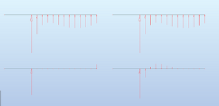

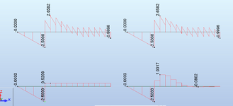

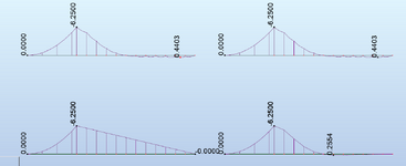

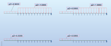

In the below images:
Left top - compression only springs through the backspan with a compression/tension spring at the far end, cantilever and backspan loaded
Left bottom - compression only springs through the backspan with a compression/tension spring at the far end, cantilever loaded
Right top - compression/tension springs, cantilever and backspan loaded
Right bottom - compression/tension springs, cantilever loaded
springs are at 12" o.c. and set to K = AE/L for a 10ft tall 2x6 SPF No2 stud
Moment:
Shear:
Reactions:
Yeah, this is an awkward thing. That said, it's ubiquitous in residential, multi-unit construction and I've yet to see it cause a problem. Most folks in my market just design the cantilever bit and disregard the rest, for better or worse. And my market is your market.
Quite often this condition will also arise where the back span is poorly braced against rollover. That's the version of this that rattles me the most.

Hey,
To clarify the loads:
Load 0 is the self weight across the whole span. On the cantilever are point loads from the roof joists above (loads 2, 3, 4 & 5). In reality the joists continue over the entire span (24"oc) but the software is showing it as a linear load (load 1). To simplify, point loads of ~120 lbf dead load & ~450 lbf snow load at intervals of 2' starting at end of cantilever.

I think my point 1/ is relevant then - be careful with assuming that loads are equal on the backspan and the cantilever
Otherwise you will underestimate the deflection and the hold down forces at the backspan
