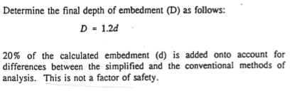

I also have 20 years plus in designing shoring systems. I'd like to chime in that PEInc's "factor of safety" on the embedment is usually added to account for the differences between refined and simplified methods. I agree with PEinc - it's much easier to have the active and passive forces on either side of the wall:
TheRick109, from what reference did you get the above diagram and, especially, the note about the extra 20% not being a safety factor? Teng does not say that about the 20%.

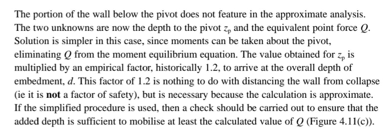

The UK Construction Industry Research and Information Association (CIRIA) makes the same point in their Manual C580.
I think this whole section of Teng's book (on cantilever walls) isn't clear. Eg do you increase the depth found from his charts? I think you do as they give depth D which is meant to be increased for FOS (step 7) but he doesn't say. (I'm also not sure the charts are for zero wall friction as stated but would need to run numbers.)
Edit: and the point I was making about the concentrated force at the toe is that it must be included if you calculate bending moment based on a free body from the toe. Otherwise the result will be wrong and in fact have tension on the wrong side of the wall.

PEinc - my reference is one of the older versions of the NYSDOT "Flexible Wall Systems". If you've ever done work for NYSDOT then you may be familiar with their requirements.
Here is the latest version of their manual:
Link
All the references used in the development of the manual are listed.
The embedment depth increase is also listed in the USS "Steel Sheet Piling Design Manual" and also many college textbooks. Everything I have refers to the additional 20% (some texts say to add 20% to 40% including AASHTO) embedment as a way to account for difference between simplified and refined methods.
In the end I guess it doesn't matter what you call it (correction factor, factor of safety, etc) as long as its accounted for.
