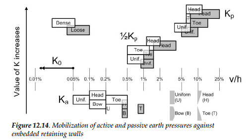

full passive pressure generally required only a very small movement (0.003 or less for half passive), so if you can stand any movement, you may be able to justify using it. For your 10 foot wall, that would be about 1/3 inch.

According to your graph as I read it, cvg, you don't get anywhere near full passive until 0.02*H, which for the case of the 10' (120") wall would be 2.4".

check again, you are misreading the graph. 1.0 Kp is at about .003 for loose sand and less for dense sand
What I considered "full" passive pressure for loose sand would be Kp = 3; half would be Kp = 1.5, corresponding to movement of nearly 0.01 ---> 1.2" for the 10' wall. It's similar for dense sand, with full passive being Kp = 8 and half being Kp = 4, crossing at a value slightly over 0.01.
From the AASHTO LRFD bridge design spec, Section C3.11.5.4: "The movement required to mobilize passive pressure is approximately 10.0 times as large as the movement needed to induce earth pressure to the active values. The movement required to mobilize full passive pressure in loose sand is approximately five percent of the height..."
Of course, that's only for sand. Mix in a little silt, clay, or larger granular material, and it changes considerably. From the same section: "For poorly compacted cohesive soils, the movement required to mobilize full passive pressure is larger than five percent of the height..."

nobody is recommending that full passive pressure be used. corps of engineers and navfac recommend no more than .5kp and only if you cant achieve stability using at rest pressure or you have a deep structure. according to the chart, .5kp would require very little movement, about .001 or .002.

For 0.5kP, EC7 indicates 1.1 to 4% of wall height for loose to dense sand, 0.011 to 0.04 x H. Thats 10 times more than cvg's Department of Navy reference.
I am sure that both methods were developed based on retaining wall monitoring at some point in time, but my gut says that 0.001 to 0.002 x H for 0.5Kp is too small a movement! For a 10ft wall thats 1/8" to 2/8" or 3 - 6mm.
