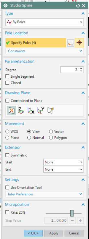

I am on NX10, and I got it to work.
Below are my settings.
Jerry J.
UGV5-NX11
Thanks for the replies. I figured it out. There are two Studio Spline commands - Studio Spline, and Studio Spline S. The one with the S does not work, the one without the S does what I expect.
Problem solved.
The one that works is the normal version of the spline command, the one that does not work (for the expanded view) is the sketch version of the spline command.
