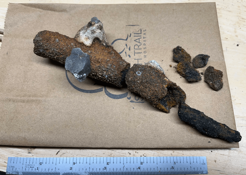

Hi. I'm a retired helicopter engineer that's taken on a project to analyze concretions found in the bay. I can tell they contain iron because they attract to a magnet. One looks like it might be a ship spike, the other was on a small plank (either side of nail hole). I imagine that they might be from an old shipwreck, I just don't know how old. I had them xrf analyzed and results are confusing me since, in addition to lots of iron oxide Fe2O3 and silicon oxide SiO2, there's many elements present including Cu, Zn, and Sn plus several race amounts of REEs. Is it possible that my xrf data can be interpreted to correlate when items were made? My target period is 16th century. It's beyond my area of expertise so I'm hoping someone on this forum has understanding of what was in compositions of metals. Thank you.

I am grateful for any feedback that you may provide. My conjecture is that this is some very dirty iron from a crude smelting process.
If one of these was sectioned would there be any solid metal to analyze?
The microstructure can also tell a lot about how and where the material was made.
Some of the ones with Cu/Zn/Sn are likely from being used to fasted brass or bronze parts into place.
Attached photo is of sample 2. It does appear to have solid metal on the inside. It broke open and in pieces when I accidentally dropped it. I sent off half of the tip end for xrf testing. The other half is available for microstructure evaluation. Who can do this? I'm a novice and what I've learned is because I found a university with fee-for-service xrf capability. Fwiw, there was no solid metal left in sample 1. At best, it (and sample 2) might reveal its inside with a CT scan, but that's another bridge too far as finding who does it. Sample 2 had higher mg/kg values of Cu, Zn, and Sn than did sample 1 (since sample 1 appeared in majority like the "corn dog" casing in photo of sample 2). I'm also curious about the other trace elements like As and Pb, plus Y, Th, and U, if these are residuals from ore. Another curious observation, the small rock on the upper spike section glows orange under ultraviolet 365nm light. I don't know why. Thanks again for thinking about puzzle. Any thought on next step is welcome.

One of the issues that you will have is that the concretion that has formed will contain a lot of entrapped material as well as corrosion products and biological residues. Considering all of the minerals in seawater this could introduce almost anything.
You would learn a lot more by sectioning the larger piece, finding some solid metal, and then looking at its composition and microstructure.
You should be able to rather quickly decide if it is recent or older.
And you want chemistry done by OES or some similar method. XRF will not give you light elements (such as C) which are critical.
Thank you MFAMET. You are right. The XRF method is capable to detect and quantify the element contents only. Not oxides. The reports were provided in oxides after recalculation. Geological reports are commonly reported in major oxides. I did not know to stipulate otherwise.
Thank you EdStainless. I will see what I can learn from sample 2 since it has solid metal. I'll look at composition and microstructure. Good to know what chemistry to do (Optical emission spectroscopy). I appreciate clues and insight to limits of xrf data for my project.

Other than microstructure and composition studies, you may want to ask lab to perform the microhardness measurement prior to etching the mounted sample. This could also provide the info of mechanical properties.
16th century? this is ancient metallurgy! ancient China, India and Middle East, people used smelting process with iron ore and silica, and added coke as heat source and reducing agent to make Fe-Si alloy. similar to cast iron. Si increase fluidity, decrease melting temp. while mechanically IMPROVE HARDNESS AND WEAR RESSTANCE. iron ores contain lots of residuals Al2O3, S, P As, Hg and some heavy metals.
oxide calculation may not be accurate, Fe has at least three oxide forms, FeO, Fe2O3 and Fe3O4 among which FeO is very weak magnetic.
by the way, attracting to a magnet does not mean it is iron base (e.g. other elements Ni, Co, Mn, and RE can be magnetic), iron-based alloy doensot necessarily mean it is magnetic (e.g. austenitic stainless is non-magnetic)
Thanks, MagBem. Roger that on your magnetism comment and of possibility for other ferrous oxides. It will be interesting to see what I can learn beyond a list of elements from xrf. So far: I'd like to CT scan the head on the concretion to see if it reveals any clues, then (as EdStainless and MFAMET suggest), perform analyses for composition and microstructure, chemistry by optical emission spectroscopy, and a microhardness measurement. Have I missed anything? Also, I only know one company in Pensacola who can do it all and they need to agree. I'm open to using other providers with capability and public-facing services to support my independent research project initiative. fwiw
