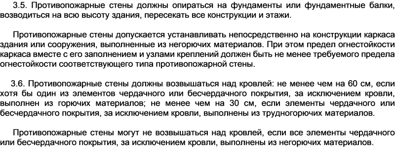

A firewall is supposed to be constructed from the ground up. But can the perimeter main columns be considered part of the firewall?
If not, then for high storey building like 10 storey. How do they make the firewall?

Let's get to the main point. If a 0.5mm (0.02") thin metal roof has no fire rating and can melt in minutes. Then why does the US code allow for 30 inches parapet above roofline to be built when the thin metal roof can easily melt and the fire can just affect the wall above the 30 inches parapet? Here's the US code about it in the article I shared in last message. Unless you Americans allow or have provision disallowing the use of any thin metal roof adjacent to higher wall? But I can't find that provision. See image below (wait for it to load if your internet is slow).

"Provide standard fire wall with at least 100 cm (39.38 in) high parapets on all portion of the the building on the property line.". "Extend exteior masonry walls to form parapets or wings".
It is easy to put a meter (39.38 in) parapets in the roofline. No problem. But the columns and foundations can no longer support RC roof slab. Only thin metal roof.
So the major question is even if you put parapet on the edge. In the event of fire, the flames can easily breach the thin metal roof and affect the adjacent building damaging it. Right??
