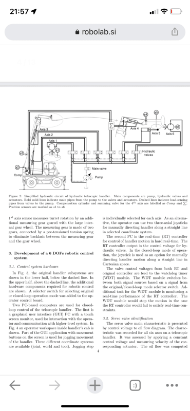

Can i help me how to calculate the compensating cylinder in the telehandler (s2) . What is force acting on this?
