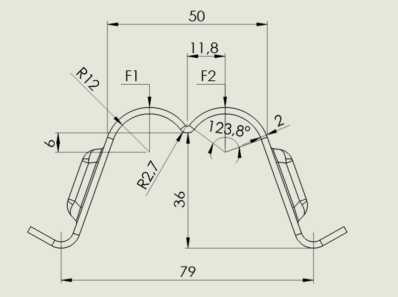

This clip will be inserted between the 2 lips of the bevelprotector. When the clip is flattened, it pushes the protector outwards to clamp against the inside of the pipe
I want to find out what happens when a total force of 18kN is placed on the arcs of the clip.
When will the point where the two arcs meet in the middle, meet the bevelprotector and how much force is necessairy for this.
Is this possible when there only is a backlash of 1mm? what will happen to the clip when a force of 18kN is applied?
Both the clip and the bevelprotector are made from steel DD11 (1.0332).
If anyone could help me get started, I would really appriciate it !
