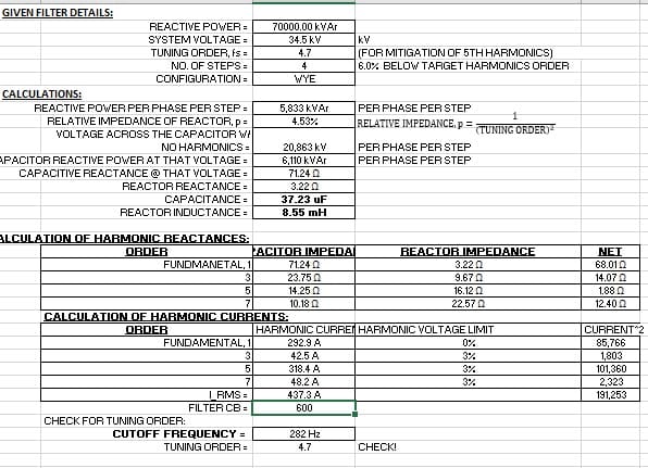

I think the fuses are blowing, as they been continuously running around 90% of their rating. It is causing a thermal stress. I want to know, how to manually calculate harmonic currents in the filter bank.
[li]I found out lately that the only mistake in the design of your filter is the sizing of the breaker, it's a bit smaller than if you apply a 125% fudge factor on the maximum Irms current that the filter will draw. My computations tell me your filter will draw a total of 437A! Please see below and check if I did it right[/li]
[li]The next trouble with my initial calculations is that I am constrained by thinking that the relative impedance of reactors is only available at a fixed % as per market availability (I tried using a relative impedance of 5%) instead of the actual relative impedance of 4.53% (tuning order = 4.7 =1/sqrt(relative impedance)! I was thinking these reactors (HV) are off-the-shelves![/li]
I hope this provides closure to your problem.
@Parchie, Thank you for the calculation. I cross checked it, and the values are accurate.

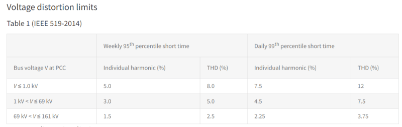

What is the significance of relative impedance and fudge factor?

What I was computing was protecting the filter unit using circuit breakers.
On the fudge factor, NEC 460.8 requires 135% of the rated capacitor current for the capacitor conductors. Other references explained that 135% is applied for grounded wye cap banks and 125% should be applied to ungrounded units (filter duty).
In 460.8(B), it says the overcurrent protection shall be as low as possible, no factor is applied to the ampacity of the conductors, which is 135% of the expected capacitor current. IDK what type of fuse you are using. A material I've read from Cooper tells about dividing the resulting conductor ampacity by 1.5 when using NEMA type T or K fuses or a fudge factor of 0.9 from the computed capacitor current rating, 1.35/1.5=0.90. Since this is a filter, that fudge factor could go down to 1.25/1.5 =0.83! Please investigate if that is your actual fuse used. Perhaps that was what the designers intended to happen: using a NEMA type T or K fuse. Using a different type of fuse will result in unwanted fuse blowing.
Here:
Fuse link amps = 1.25/1.5 x 437.3 = 363A, hence, a 400A fuse, NEMA type T or K!
On the relative impedance thing, it is another way of expressing the tuning order like the way you computed. You can also use the target cutoff frequency in computing the element values. Tuning order = sqrt(1/relative impedance).

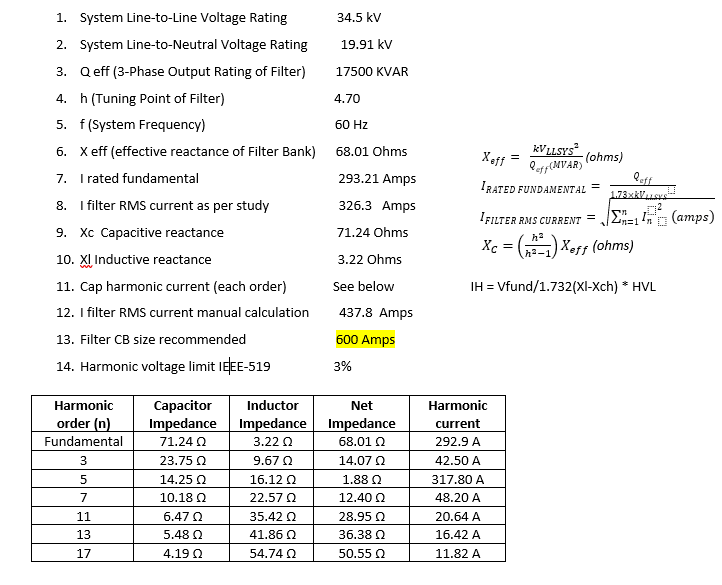

Aditya,
to me the recent calculation seem to be correct (beside the fact that the fundamental voltage at the capacitors will be higher as the incoming voltage due to the inductor - line 7).
So, the 400 A fuse just does its job when it trips at 437.8 A.
But what study led to the RMS value of 326.3 A (line 8) ? This might be valid for an untuned bank, but for sure not for the filter design.
@ electricuwe (Electrical)
Thank you for the cross check.
Line 8 item was a rough estimate and it is for cap bank only. And we didn't perform post installation harmonic study, this estimate is before installation of filter bank.
