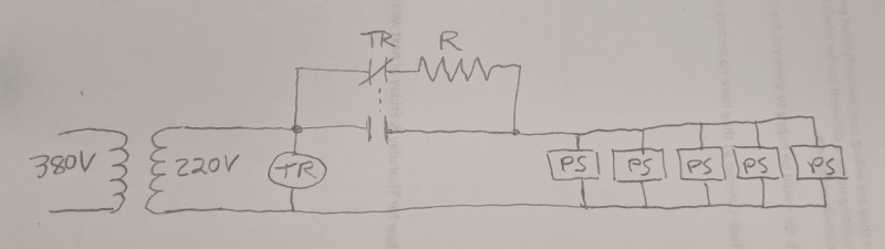

Paul; You can always play the stereo amplifier game. Amps have big banks of capacitors that draw a very large current on start-up because they look like a dead-short when discharged. To prevent popped fuses and tripped breakers and needing expensive power switches to handle the inrush, they put in a relay that closes* on power up putting a resistor in series with the caps for a few seconds. Once the caps have been charged -without any excess inrush- the relay opens hooking the now charged caps to the rectifier bank. The relay doesn't have to be particularly large since it never has to carry an uncontrolled inrush.

Hi Keith,
Inrush limiting sounds like a great idea. If I attempted to do the relay method, do you think something like I've sketched below would be a reasonable approach. I figure I could put a Timed Relay (TR) with a 220 VAC coil across the 220 VAC circuit (tranformer secondary). Then I would put the normally open and normally closed contacts of the timed relay (TR) in a parallel circuit that would determine whether my five power supplies (PS) would receive power through the resistor or directly. If the normally closed contact is closed when the coil is de-energized and for a few seconds after the coil is energized (until the timer completes), the Power Supplies would charge up through the resistor during what would be the inrush period. After the timer completes, the normally open contact would close and the normally closed contact would open, therefore bypassing the resistor and powering the power supplies directly.

The normally closed contacts are an additional point of failure and are not needed.
All you need is a set of normally open contacts across the resistor to short it out of the circuit.

Thank you Bill - that makes sense. - Paul

Bill's point is good and the normal way it's done. The resistor is always in circuit when the power comes on it always flows thru the resistor. The relay just shorts the resistor for a nice little closed-transition setup.
Otherwise, you've got it!
