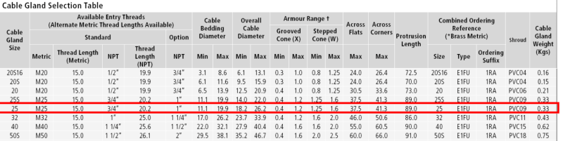

EATON cable glands comes with many sealing ranges for the same gland size, Eaton gland selection chart below
Where as CMP glands comes with one sealing range for the same gland size, CMP gland selection chart below
Why do EATON have many sealing ranges for the same gland size, whereas CMP glands have one sealing range? What are the advantages/disadvantages on this?
