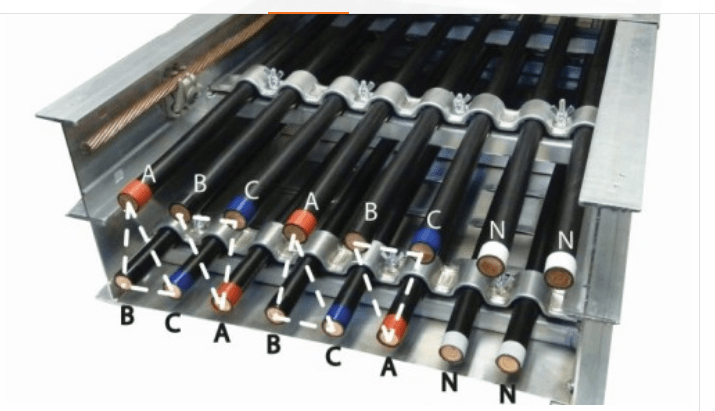

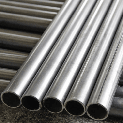

It may be mitigated by multiple condustors spaced 2" or more apart or by hollow bus bars. Aluminum or copper pipe in iron pipe sizes is often used as bus bars for high currents in substations.
See "Cable Bus":
Cable bus may be supplied with more than two layers of cables.
See IPS Bus (Iron Pipe Size)
