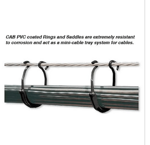

Not sure what you mean by a CAB support system.
Is this it?
Screenshot_2023-06-07_at_14-52-56_PVC_Coated_Aerial_Cable_Rings_from_CAB_-_Cableorganizer.com_dwzwyu.png
