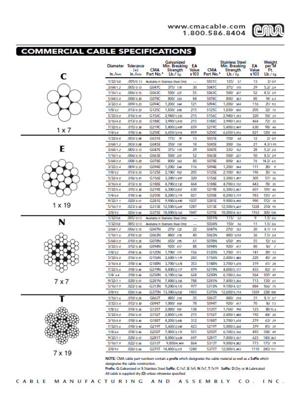

I came across this chart that included EA values years ago when performing similar calculations.
That company doesn't appear to be around anymore.
This was also in my archive.
Wire Rope Stretch
I cannot attest to the accuracy of either of these documents - provided for information only.
