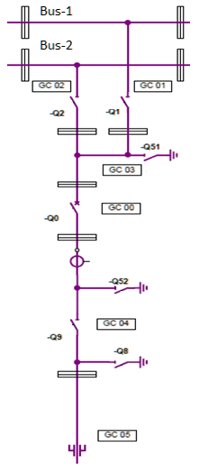

What is the purpose of manufacturers/engineers placing disconnects smack in the middle of busbars? Seems pointless, and if anything reduces the availability of any one busbar. Anyone agree this is pointlessly stupid?
It allows deenergized work on a bus section to occur.
In GIS, this will increase availability and service continuity during repair works involving bus section or sections adjoining bus sections.

@Stevenal: I get that, but isn't that why the bus is replicated to begin with? Just place everything on the A bus and take the B bus out of service and visa versa. Seems overly complicated, especially for a 6/7 bay station like this.

Important points in GIS:
1. Repair works can take long time, may be ~3 months depending on spares required.
2, In case of fault between Bus-1 & Bus-2 disconnector (GC-03), both bus shutdown is required during repair work.
Sushilksk: Thank you! This is the explanation I was looking for! That would make a lot of sense now that I think about it- purple star given. [smile]
I'm attaching 3 PDFs on the subject of GIS continuity- asking out of curiosity- but could the GIS bus and isolator partitions be designed such that busbars do not need to be taken out of service for repair on section GC-03? I'm guessing no in that from what I'm reading the neighboring compartment (that would the isolators GC-01 and GC-02) needs to be at reduced SF6 pressure during repair of GC-03 even (if) gas tight barriers existed between each busbar and GC-01 and GC-02.

That would require more partitions, more space, more cost, more chamces of failure...

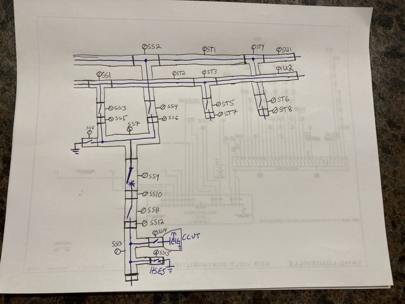

Alright, so off the cuff I drew this up. I added an extra partition between SS3 and SS7, also SS4 and SS7. Ditto for the busbars where the disconnects have a barrier between them and each bus.
Would this work, in theory at least? Cost, space and complexity noted and I am in agreement.
(and yuppers the isolators and breaker are drawn the wrong direction)

Perhaps I used the wrong choice of words in my original post- and for that I offer my sincere apologies to everyone in this thread.
Valid point. Though I'm having a hard time giving up SS6.
