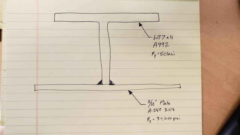

Hello All,
Any help or guidance on the following is greatly appreciated! I'm tasked with analyzing a built-up I-shaped member composed of A-992 WT7x11 and 304 SS 3/16" plate, under simply supported combined major axis bending and axial compression. I've done some research and believe using the transformed section (A.K.A. transformed width) method to find the moments/stresses followed by AISC 360-16 F4. OTHER I-SHAPED MEMBERS WITH COMPACT OR NONCOMPACT WEBS BENT ABOUT THEIR MAJOR AXIS to find the allowable moment is the way to go. However, what I'm getting hung up on is the requirement that the entire section must remain within the proportional limit (i.e., no part of the section can plastically yield) when using the transformed section method and from what I understand, AISC 360-16 F4 is based on some plastic yielding happening throughout the section. Is there a way to modify AISC 360-16 F4 to limit the yielding to the elastic limit or maybe there's another method that I should be using? Thanks in advance for your help!
A similar question was discussed in Modern Steel where they were reinforcing a 50ksi I-section with 36ksi plate. It discusses how to apply each limit state included in F4.
When you calculate your section properties, "My" will use Fy of 30ksi since that is when yielding will first begin. For "Mp", you use Fy of 30ksi and 50ksi (this should be coordinated with your "transformed width").

What I'm actually doing is using the WT or angle to stiffen a plate. So I'm using a width of 16 x plate thickness for the tension flange, see below. I like your idea of conservatively using only part of the plate in order to analyze it as a channel, but I don't see a part in AISC 360 applicable to analyzing channels other than F2. DOUBLY SYMMETRIC COMPACT I-SHAPED MEMBERS AND CHANNELS BENT ABOUT THEIR MAJOR AXIS but I believe that is for singly symmetric channels whereas this would be asymmetric.

What's the full picture of this structure? The plate that you're stiffening might provide restraint, in which case the code buckling capacity calculations would be conservative if you apply them to your design section as though it exists in isolation.
Under what conditions must the steel not yield? The code safety factors might be enough to prevent yielding under working loads even though they're based on plastic capacity in some cases.
Both comments can be safely disregarded if you don't need the leanest design.
Great questions... The angle or WT is one of many external rafters that support a conical plate roof on an API650 tank. Very interested to hear your thoughts on if the plate will provide restraint and if AISC F4 equations will be conservative. Note that the SS plate will be in tension.

The plate will act as a continuous twist restraint to the composite beam even though it's at the tension flange. Presumably the stiffeners are at reasonable spacing compared to the plate stiffness so the increase in flexural buckling capacity would be substantial.
I agree the cone roof plate will act as a twist restraint but not sure how to quantify it in relation to flexural buckling. Any idea on that? Know of a resource to use?
Am I the only one who's concerned about galvanic corrosion issues when these two different metals are welded together?
Or are you implying that Lb = 0ft and F4.2 Lateral-Torsional Buckling will not apply?
"When Lb ≤ Lp, the limit state of lateral-torsional buckling does not apply."
"Lb = length between points that are either braced against lateral displacement of the compression flange or braced against twist of the cross section, in. (mm)"
