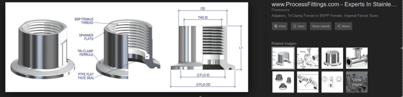

So basically I am wondering what torque to use on a BSPP fitting similar to this link below. I want to compress the washer inside but my torque value will determine how much the rubber washer compresses. I understand you need durometer value to determine this also, but assuming a 60-70 durometer rubber what would i need to torque a 1" fitting to seal this type of fitting. I cannot find any standard for this anywhere. Thanks

I am not sure what you mean. So there are also whats called a banjo seal with is a bonded washer used for BSPP fittings which have their own torque value, however this is a rubber flat washer
What Ed describes is usually done with an o-ring in a groove. You tighten until you get metal to metal contact, and then the groove depth controls the amount of compression of the o-ring.

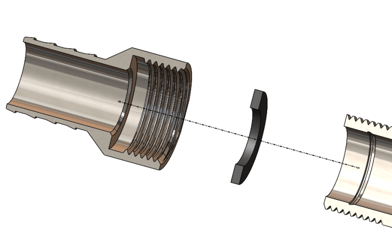

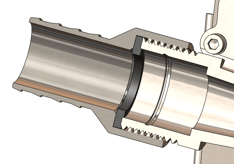

Here is a bit more info. You can see what I am talking aout. Essentially I would be torquing the fitting to compress the washer to seal the outlet of a water pump.

Loading for a seal of this type should be based on a compression percentage- this is very easy
-measure your seal thickness
-determine how much compression you need (10% as stated above is a reasonable starting point)
-calculate how much the fitting needs to move axially to compress the seal 10%
-using the thread pitch, calculate how many turns (or, more likely, what fraction of a turn) will result in 10% seal compression
Then instruct your people to install that fitting finger tight, and then add 1/4 turn or whatever you calculated
Also note that the seal design you've shown is likely to result in seal extrusion- you don't want a flat gasket to hang over an edge if you can help it. If this is any type of critical sealing application, and I were the designer, I would look for a fitting that uses an o-ring in a groove in the sealing face of the female fitting.
The seal design that you show is not consistent with the design intent of BSPP.

definitely will use thread sealant. The fact the manufacturer even has this thread on an outlet without the typical design to seal it makes no sense. However I have seen fittings with this exact design for BSP triclamp fittings so it is done just not a standard from what I can find.

What's the application here - you mention water pump, is this a hose fitting for an engine or something?
Considering the type of hosetail fitting you're showing here, in real life I would doubt that anyone actually working on this is reaching for a torque wrench or considering the number of turns - eyeballing a quarter turn on that fitting is about the best you would get, certainly not accurate.
What's the pressure/temperature of the working fluid? If this is the outlet the pump manufacturer has selected, maybe its not a critical connection, and as long as you tighten it up and tighten it a bit more if it leaks, that's ok...
One thing that is generally true - rubber is incompressible. Any force required goes to elastic deformation, which is highly constraint dependent. Rubber also has very high thermal expansion coefficient so an amount of deformation that is suitable at one temperature won't work at another.
