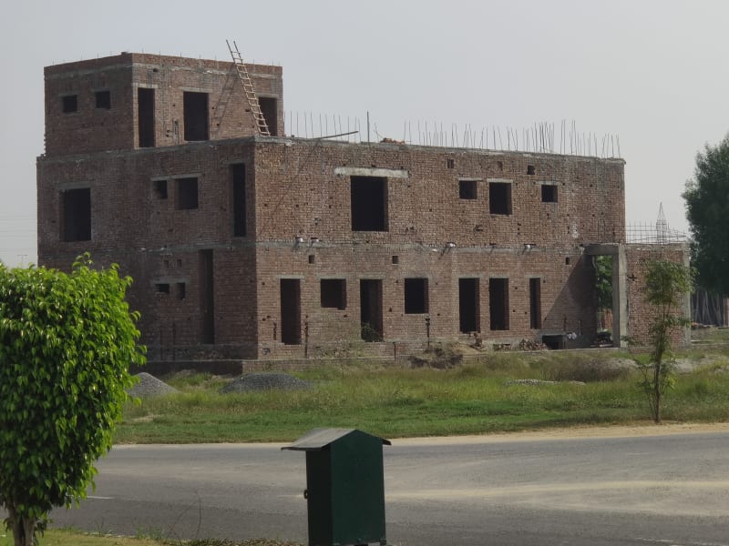

The house i shared was to let you guys know how homes are built here you can see there are no columms in the house apart from the 2 that are in the garage porch

Based on my experience in this region the building you have shown is pretty typical, but that does not mean it will be very safe, particularly in the case of an earthquake. Even if it is common, it probably would not meet local building codes for earthquake design. I'm not familiar with the codes in Pakistan, but in India the construction can be very similar and the codes are often still not followed. Without some vertical and horizontal reinforcing elements, this building would have trouble resisting the lateral forces of an earthquake.
It appears that Lahore is in an area of lesser seismic activity but that does not mean it is without risk. An engineer should refer to a seismic map of the country to determine what level of earthquake resistant design is appropriate. Delhi for example is also in a region of rather low seismicity compared to the Himilayas, however, compared to the rest of the world, it still has significant earthquake risk. Based on this seismic map of India, Lahore would appear to be similar to Delhi and in Zone III or IV per Indian Standards (Medium to High Risk):

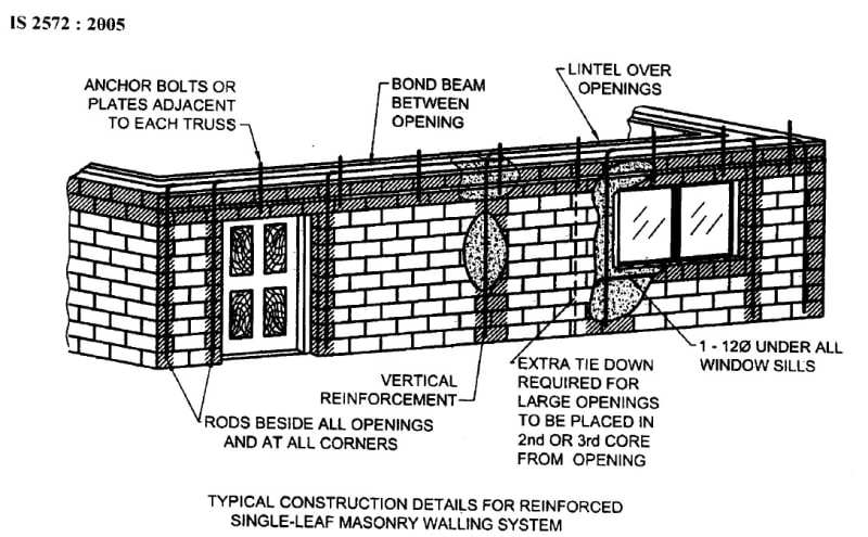

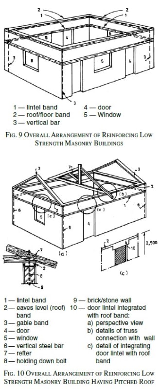

Let me outline 3 types of masonry construction mentioned in the Indian Standards:
[ol 1]
[li]RC Frame with Masonry Infill Walls - This certainly common for larger structures, but smaller residential structures also. It consists of a reinforced concrete frame with infill brick masonry. This is widely used in the region and can be designed to resist earthquake loads, but the masonry is not a structural element in this case, or if so, only in a very localized sense (the wall supports itself, but not the structure). [/li]
[li]Minimally Reinforced Masonry with RC Bands and Vertical Bars - This seems to be the type of construction you are going for. This method still requires the use of reinforced concrete reinforcement to strengthen the structure for lateral loads (earthquakes). The structure does not so much depend on the width of the walls for resisting lateral loads as it does the whole structure acting together with the reinforced concrete helping it to behave as a unit. The hollow areas of your blocks could be used for adding reinforcing steel and concrete to form posts inside of the wall. As was mentioned by others, these gaps are rather small, so you may need to have multiple hollows adjacently used for this. Horizontal bands should also be incorporated into the design.

[li]IS 2572:2005 - Construction of Hollow and Solid Concrete Block Masonry[/li]
[li]IS 4236:2013 - Earthquake Resistant Design and Construction[/li]

From: IS 2752
From: IS 4326
