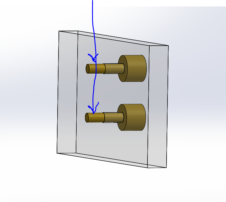

Hello engineers,
I have a fixture designed with 1/4" glass (untempered) and two brass rods going through it, 1/8" diameter. There will be a force downward on the rods, probably max 10lbf total. I'm trying to see if I need to put a bushing in there or rubber, or if I can get away with just the rods going through the hole in the glass. I've never really worked with glass, so this might be a silly question. Any insight greatly appreciated.
Thanks,
Josh
> you show two diameter changes on the rod, where are these in relationship to the glass?
> how is the hole made and what is its finish?
TTFN (ta ta for now)
I can do absolutely anything. I'm an expert! faq731-376 forum1529
Sorry, the transparency makes it a little confusing. The diameter change is on the back face of the glass. On the other side(front side) the two rods actually thread into one piece, which gets the downward force.
The hole will most likely be water jet cut. But possibly drilled. No finishing operations though.

I'm not personally familiar with water-jet cutting; does it leave sharp edges or chips?
Unless the glass has no surface imperfections loaded by the rods, there would be some likelihood that you might crack the glass.
Is the loading a instantaneous, singular, event, or is it repetitive? How much slop is there between the rod and the hole?

Waterjet leaves a sharp edge.
The object is a hook of sorts. So people will hang some weight on it..leave it there... take it off... repeat.
I guess it would be safe to add a layer of rubber or plastic around the rods? Although I'm having a hard time finding an off the shelf bushing with sizing that would work. Do you think a layer of 0.006" rubber is enough to stop potential cracking?

Seems to me that would depend on the compressibility of the rubber, but the rubber needs to give quite a bit to minimize the stress on the glass, so I'd guess that 6 mils is a bit thin; it's about the thickness of 2 sheets of paper, isn't it?

Yeah, about 2 sheets. So I guess I'll look for something around 20 mil or so to wrap around it. Am I correct that I would want a lower durometer rubber? Something around 40 or so?
You might find some low Duro urethane for the cushions.
Glass is very unforgiving when it comes to edge loading, alignment, and impact.
You do want to use plastic washers and bushing. Nylon or polyethylene would be appropriate. You do not want to use a soft rubber. The purpose of the plastic is to deform where the loads too high so the load can be spread over a larger area, but you do not want the washers or bushing to move as the loads vary. A small burr or other imperfection will crack the glass if you tighten metal directly to glass.
Amen to plastic bushings.
Probably best to bond them in, since the waterjetted surface will be perfectly abraded for bonding. ... and for providing microscopic stress raisers.
You could probably get away with suspending _one_ brass object from a fire-polished hole, but not two.

People hanging stuff and 10lb load does not mix. Whatever they hang on it, someone is eventually going to yank it down/off instead of gently removing it.
If that's 1/4" glass, then those are 1/8" rods, they will be flexible. What happens when they bend inside the hole using the front edge as a fulcrum, and pry upwards towards the middle/back?
