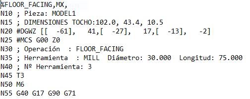

Hi, I need some help. I am configuring a postprocessor with post confiturator and I need a line between brackets to appear in the output file.
Ex: [DGWZ [-10], 10 [-20], .....]
When I confit a variabel with the bracket, it gives me an error because it expects the closed bracket. Is there a way to insert that character into a variable?
Thank you.
Thank you very much, it works perfectly.
A great!
