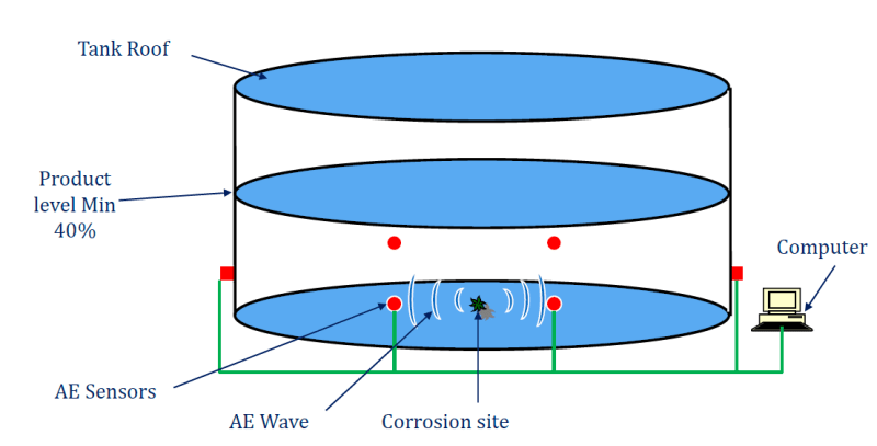

Hey guys. Hope everybody is fine.
Do you know is there are any method, technique or other test that could be carried out to check bottom plates of a storage tank (it contains molten salts at 500°C)? We wish to know bottom plates integrity. We can access to bottom plate external (as it can be seen in picture attached).
ANy ideas?
Hello Eduardo1982,

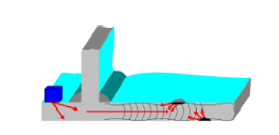

It is possible to know the bottom plate of High temperature insulated tank integrity externally, but upto what extend matters,
There are methods such as Guided Wave Ultrasound Inspection and Acoustic Emission Testing(AET), If you want to know more about these techniques, please let me know
Yes Bala. It sounds great. How could i get more info about this technique? do you know any company what execute this test?
Just search Guided wave ultrasonic inspection.
The problem with GWUT and many other similar techniques is that they don't like welds and seeing past a weld gets difficult and less accurate.
As the base plate of your tank is likely to have many plates and many welds, you need to be able to tell the companies what they are facing so that they can tell you what is possible.

The only good way is to drain and clean the tank and the do a UT sweep of the entire floor.
