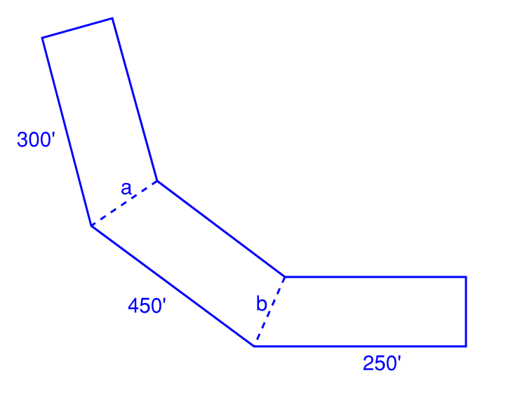

For a boomerang shaped building, does anyone see an alternative to braced frames and double column lines at a and b in the sketch below?
Building is located in the southeast, low seismic. Single story, tilt panels, bar joist and metal deck roof.
i feel like sliding expansion joints would bind at these intersections
If you have a rigid roof diaphragm, or the metal deck with diagonal horizontal members, and those solid long walls are shear walls, there's enough of a perpendicular lateral component to not need bracing at a and b. I wouldn't use expansion joints, and keep the whole thing continuous. The tricky part is chord continuity at the angles of the long walls.
Because of the transition in direction, I would likely put a joint at a and b and treat them as separate buildings. The individual components appear to be big enough.
@milkshakelake thats an interesting though but im not comfortable stretching a building 1000' without some consideration for expansion. not sure the diaphragm aspect ratio will work out either
