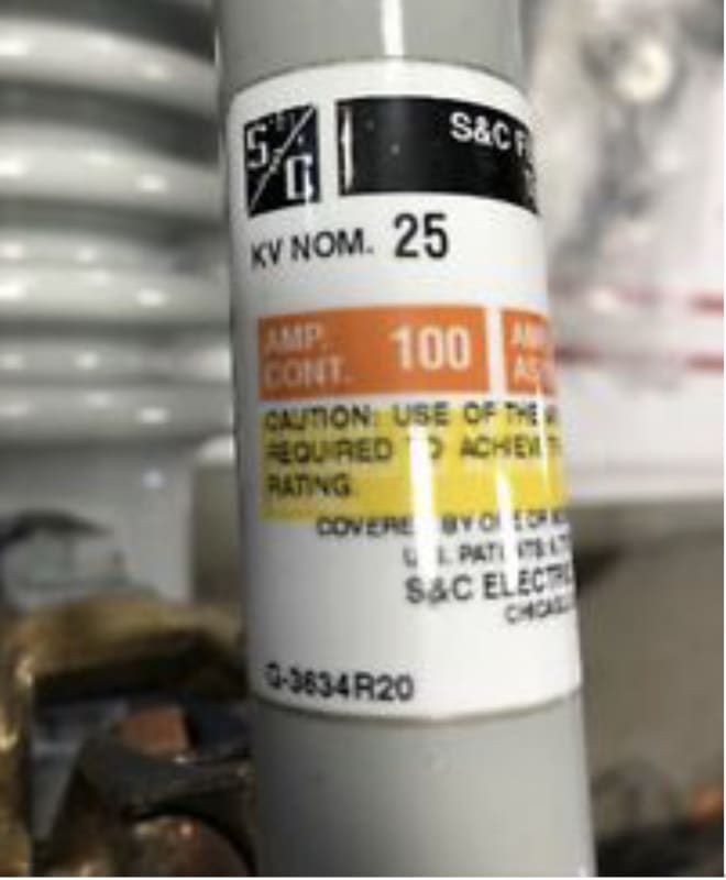

That is a distribution fused cutout. Here are some links explaining how they work and the video shows the actual fuse element inside the cutout:
Typically utility folks refer to voltages above 69,000 volts as transmission versus voltages below 35,000 volts as distribution. From the length of insulators, my guess this distribution circuit is around 25,000 volts (25 kV).

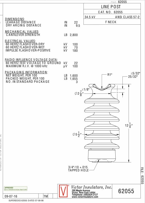

Cut-out rated for 25 kV is a good guess. Line post insulator may be rated for 34.5 kV but could be operated at lower voltage. (see below)
This cut-out is feeding a riser cable going to a pad mount transformer. Since the cut-out fuse blew and the cut out fuse holder fell open as it is designed to do, this would obviously indicate a fault. Therefore, I am surprised that the utility lineman just re-fused the cutout and closed it back in. As you probably realized, the cut out makes a very loud noise when it blows.

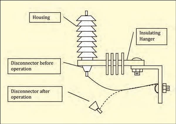

Here's the other difference in the first picture. I would say it's the remains of the arrester housing following a failure.
I agree. Actually it seems like two separate parts of the housing ended up missing, the middle and the bottom. The arrester was not replaced in the second picture, but service restored with the ground lead disconnector operated. What I initially thought was a squirrel guard on the top (darker color) now seems like a burnt portion of the housing.
Now you are making me think, what is in the arrester that would stay intact after an operation?
I would think the blocks would come apart.
If this was a big event I would understand, refuse and move on. But if this were just a random failure, why would the serviceman not replace the arrester?
Expect another outage, by someone else, to replace the arrester.
It's not intact, the ground wire is missing.
No arrester on the truck, and customers want the juice back on. Restore power and report the failure for a scheduled outage.
A lot of the polymer arrestors will not simply blow the bottom disconnector as the picture above shows. They will take some smaller shots and separate at different points anywhere on the arrest or. I see them with the tops blown off, blown in half, etc..
And late at night, it’s a simple matter to push it up out of the way and throw the fuse back in. Work on replacing it on regular time during the daylight hours.
An arrestor can often later be replaced without an outage using hot sticks. It is common for a trouble crew to make a temporary fix and have fully equipped crew to return during the day to make permanent repairs.
