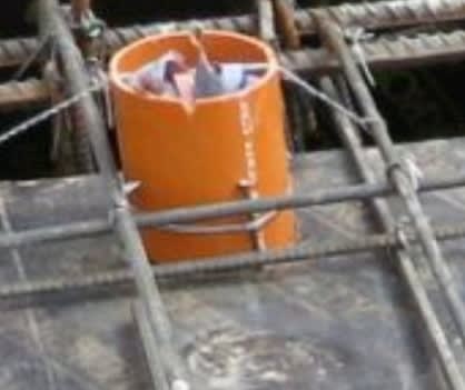

Concerning the above. Here is the photo of the technique. Before the 5" slab concrete was put, a 4" PVC stub out was placed. Then the stub out was hammered out to put either long pipe for storm drain or put any length PVC for aircon cooper tubes, etc.
Don't you use this technique? Why?
So would sealing the bottom with normal sealant and then using low viscosity epoxy above be able to fill the gap between PVC and hole? The orange stub out is just temporary. After the slab cured, the orange stub out is usually removed and replace with same diameter PVC enough for exact fit but still there is gap for water to leak from above. The balcony gets flooded during flash rain and it will become more common as climate change rules tthe weather. Thank you.

Both. For the PVC tube with aircon cooper tubes inside. A temporary pipe was put and then replaced with a more permanent one. Same sized.
For others. The slab was drilled with additional holes for draining rain water. For example, with 2 inches hole, 2" PVC pipe is installed.
So they have same gap. So would sealing the bottom with sealant and pouring low viscosity epoxy above be able to fill the gap or not?
Yes provided you can create a seal at the bottom.
