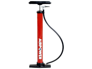

There is something to be said for a simple tire pump.
Hi dvd,
thank you for the reply and suggestion isn't this a bit small and would take a lot of time and effort as the car weight is on it.

Patch kit from AutoZone, followed by a LOT of repititous motion with the bike pump... even had the munchkin come out and pump for a while. Reminded me how badly I could use a portable air compressor. The bike pump works, but my arms are SORE!
