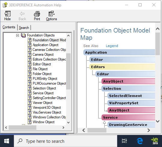

Automation documentation can be found under Help > Infrastructure > Automation Documentation Home Page. The organization of those help files is different than the rest of Catia. It takes a little getting used to, but it's pretty thorough.
Not sure if that's the same content that ferdo is pointing you to. CHM files are passing into obsolescence. I don't think Windows 10 supports them any more.
Documentation can be found also online
Chm files not obsolete in win 10 (yet).
Regards
Fernando
"CHM files are passing into obsolescence. I don't think Windows 10 supports them any more."
Not even close. I have at least 3 copies of the automation CHM open on my screen, at any given time. Granted, most of them are VB/VBA, and that IS passing into obsolescence. But while syntax varies between languages, the API remains the same.
