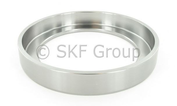

I forget word "spacer", i mean inner spacer ring(L) and outer spacer ring (k).
like the picture.
OK, that makes it more understandable.

Getting into specifics of your assembly would be a challenge for me. I would guess that the particular spacer photo you show above would go between the bearing housing and the first or last bearing housing in that stack… in that case the flat side should be against the bearing (you don't want that thin rim pressing against the outer ring). I'm not sure how many spacers you have total or what their shapes are. If you give more details then maybe I could give some guesses (but other people on here like Tmoose could give waay better guesses). Of course getting hold of a drawing or talking to motor OEM (or possibly bearing manufacturer) is the most reliable way to get good advice.
