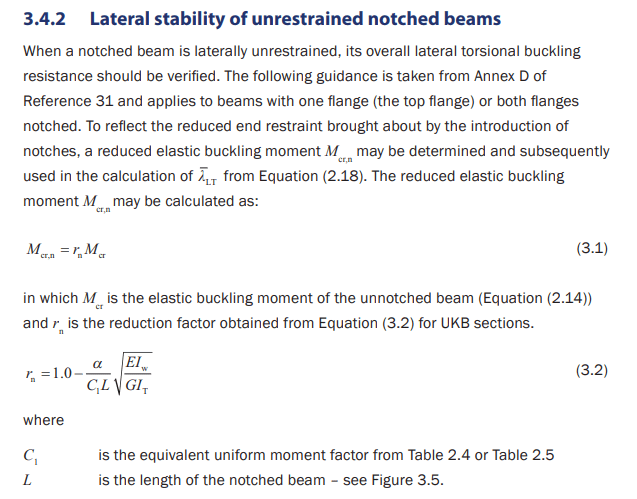

One more point, in case of bolted joints either with fin plate or angle cleat, I would have to use coped beam. But as beam flanges are unrestrained (floor used being open mesh grating) there is requirement to prove the notch stability (SCI P358) which is not given in green book for beams with both flange notch. Anyway what you will prefer in such scenario?

In case of bolted joints involving fin plate & coped beam with flanges, do you justify the notch stability (SCI P358) which is not given in green book for beams with both flange notch. Or you just use the criteria of short fin to notch and close this matter.

- Regarding the stability of double notched unrestrained beams, SCI P360 may be useful for you:
For a better understanding of stability in EC; ECCS Pub. 119: Rules for Member Stability in EN 1993-1-1 is a worthy starter.
