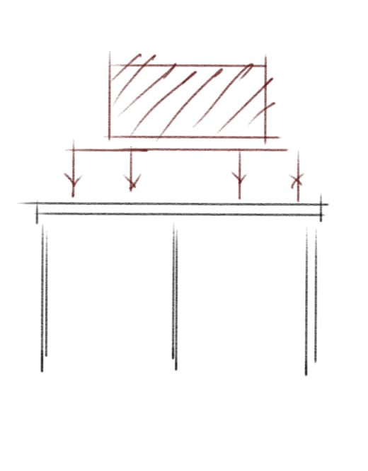

I would like to span a new beam across several existing walls and need the reaction to be relatively uniform. Most of the load is fairly well known dead load. Therefore I'd like to use a spring support. However, I'm not sure what this would actually be. I see various spring supports used for mechanical equipment (the first that comes to find is a canned coil support or vibration springs for large condensers), but was wondering if there is something specifically made to support structural steel. I need a fairly flexible spring, about 6kip/in that can deflect about 2", which likely rules out elastomeric bearing pads. Does anyone know of a product that could be used or has done something similar?

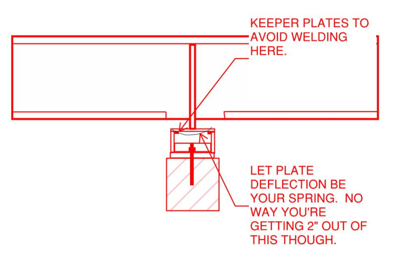

4) I couldn't resist the temptation to try to be creative on this, ergo the sketch below. Fairly predictable but no way in hell you're getting 2" travel out of that kind of setup. You also lose your bottom flange continuity but, if the rest of this would be doable, we could solve that easily enough.
- Not a bad idea.

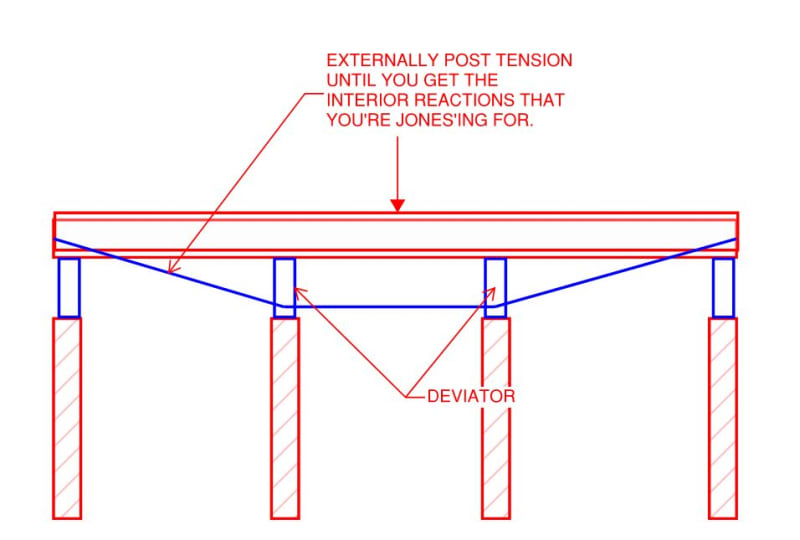

Very solid idea. I'm not exactly sure how I would go about the post tensioning or what the deviator's are, but I probably feel just as comfortable about those 'unknowns' as I do the springs.
EIT
RFeund said:
I'm not exactly sure how I would go about the post-tensioning or what the deviator's are
1) Something like a Dywidag all thread bar that you tension by tightening nuts at the end. You're kind of just building a truss and inducing some negative camber in it after the fact.
2) The deviator's just a hinged post or whatever that causes the tendon profile to "deviate" from the beam centroid. Jargon.
