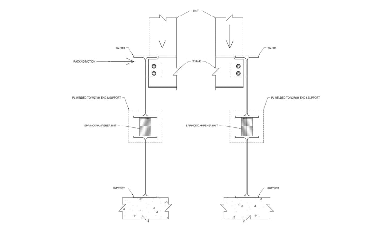

Have an issue with a large piece of equipment sitting off the web of the main support beam - see sketch below:
Field crew claims the web is bending inward along with the top flange, and the member isn't even fully loaded yet.
What, in your opinion, would be the most economical approach to rectifying this issue?
Would, say, full-height stiffener plates along the beam's length (under the unit) make the most sense? Or maybe a channel member along the outside (accessible) portion of the beam?
Any advice/insight would be greatly appreciated.

I've attached a basic flowchart for transverse stiffener design. You might be able to size the stiffener for strength only considering the contribution from one side. However, your situation seems to be more of a serviceability/deformation issue that's affecting performance.
Stiffening on the left side would help activate the whole cross section in resisting the torsion and provide a load path to the dampener other than flexure of the left-side bottom flange.
In any case, the old adage, "when in doubt, make it stout" applies. It's always good to stiffen beams under concentrated loads, especially at beam ends.
To me, the description of the movement sounds less like cross section distortion and more like pure torsion/twist. If it is torsion/twist, I would not expect stiffeners to be very effective. Instead, I would focus on making effective roll beams out any transverse framing present. And perhaps adding more.

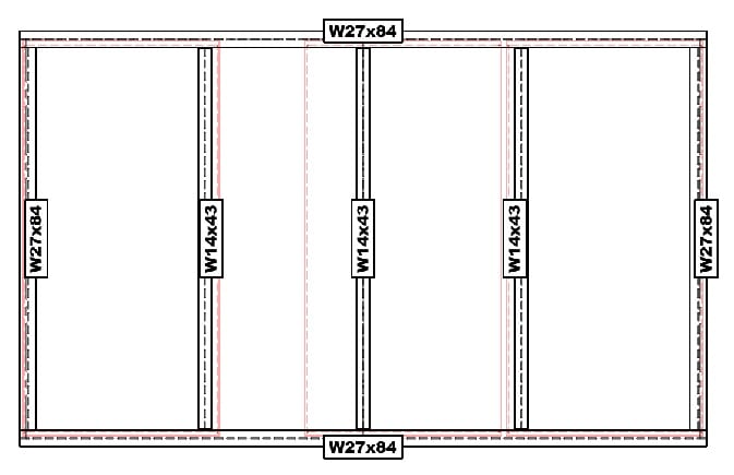

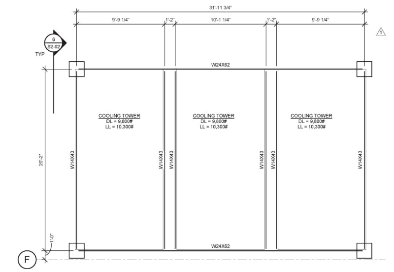

A plan view of the situation would be useful
Here's a plan view (red lines indicate outline & bolt pattern of equipment):
(Overall dim's are approximately 33'x21')
Planning on visiting the site later today to get more info.

1) is that small transverse beam fixed onto the larger beam ? I know we'd normally assume pinned (conservative for the beam, not so conservative for the end attachments). That would push more torsion into the joint.
2) what sort of shear is being applied ?
3) the question is "is the web deforming due to the offset shear (in which case stiffeners would help the web) or is it torsion on the section (so the whole section is twisting, something you can check) then you'd need something to make the large beam more effective in torsion (like a 2nd web to make an enclosed box area)

Update: after visiting the site the issue isn't entirely clear, but there are some more variables to consider.
1) There are springs between the unit support steel & the steel anchored to the concrete footings; springs are only about 5"wide, and the bf of the unit support steel is 10"w
2) The entire support assembly was shipped with welded plates at each corner - the contractor reached out us after removing one of said plates & noticed the steel frame "racking"
3) Measurements that were taken don't quite jibe with what was expected - they were taken at each end & the center, and each location indicates a somewhat different scenario (?)

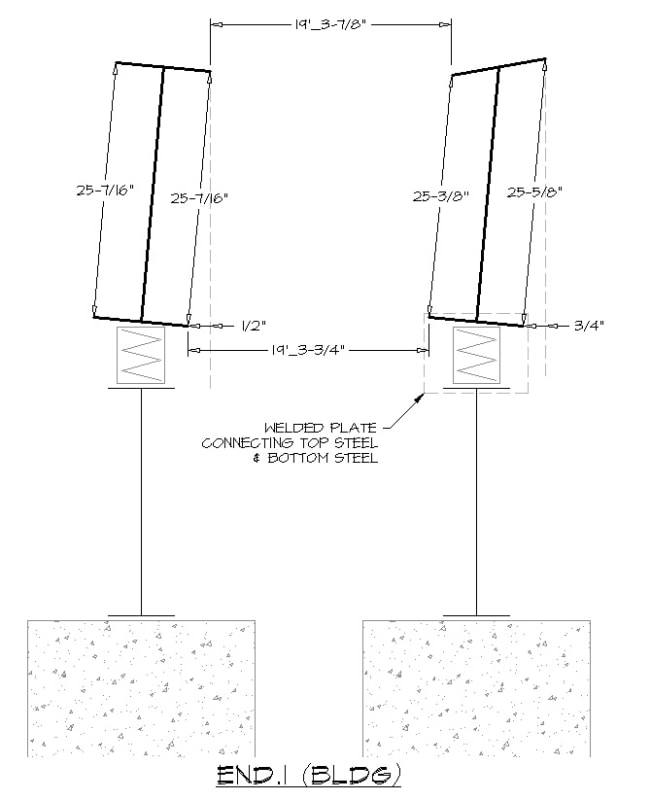

a) end.1 _ beam to beam top flanges distance measurement is 1/8" longer than the bottom flanges measurement
one beam showed the inside height (d-2tf) to be nearly 1/4" shorter on the inside of the frame
both of the top flanges appeared to lean to one side - one @ 1/2"offset & the other @ 3/4"offset​

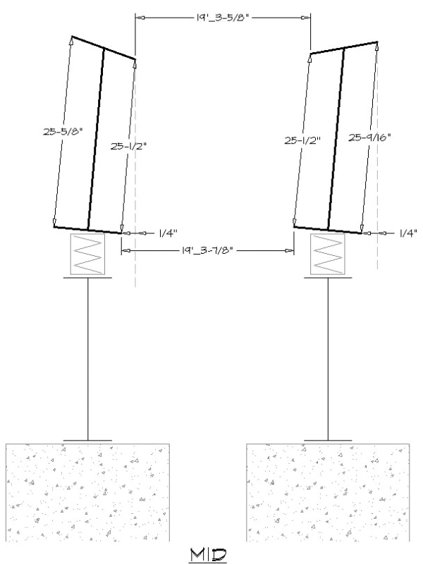

b) mid _ beam to beam top flanges distance measurement is 1/4" shorter than the bottom flanges measurement
both beams showed the inside height to be nearly 1/8" shorter on the inside of the frame
both of the top flanges appeared to lean 1/4" the same direction​

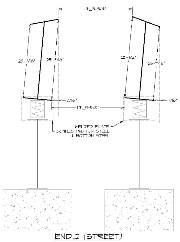

c) end.2 _ beam to beam top flanges distance is 1/8" longer than the bottom
both beams showed the inside height to be nearly 1/8" taller on the inside of the frame
both of the top flanges appear to lean nearly 1/8" the same direction​
I've included an exaggerated sketch of each scenario below to help clarify:

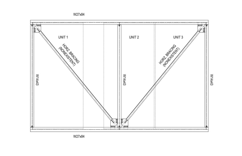

I don't mean to be obtuse, but why wouldn't a frame composed of (2) W27x84's, on springs, w/ (3) perpendicular W14x43's (pinned conx's at ends to W27x84's) be expected to rack? Welded plates at the ends of the W27x84's aren't going to do much. The guys loading the heavy units onto the frame, with the crane, aren't going to be gentle. It's going to experience some significant horizontal loading.
Unless I'm missing something, it doesn't looks very horizontally stable.
I'm not a module guy, but I'd expect some sort of horizontal bracing or moment connections, like this sketch. Best of luck man.

Given the dimensions shown I'd expect lateral restraints on the top and bottom I-beams since there are springs there, both I beams are slender unstiffened columns. with a pin (spring) in the middle.
Also given the springs and the heavy item, you would expect everthing else needs to be quite stiff as the springs are presumably isolating vibrations into our out of the equipment.

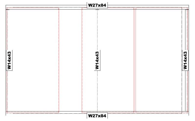

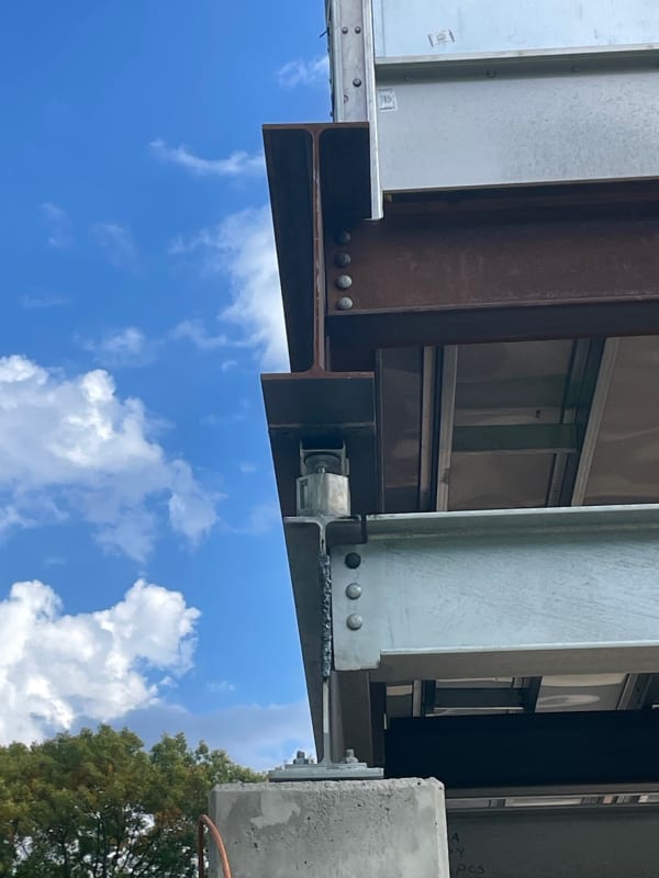

Here is the plan for the base steel (per structural):
And here's a photo of the corner (w/removed steel plate):
One though that was brought up was installing 2 additional W27s at each end & shifting the 2 W14s inward, similar to below:
This seems costly (and I'm somewhat doubtful it would resolve the issue at hand); I think I'm leaning towards DrZoidberWoop's suggestion of adding some horizontal bracing, along with some stiffener plates to account for the offset shear.

Seems to me like the lower frame should just have been removed from the get-go. You've got a stack of wobbly steel now and it looks like it is performing as one would expect a stack of wobbly steel to perform. I'm guessing the lower, older frame was simply left in place to save money / avoid re-routing piping, etc., and no longer serves any purpose?
I would add vertical bracing to stabilize this whole thing(plus horizontal bracing to prevent the local distortion, like Dr. Zoidberg suggested). That would likely transmit some vibration though.
Ideally you'd pull the units off and rebuild this thing, but that ship may have sailed. You've got a bit of a mess on your hands here, OP.

Though I would used two sets of vertical bracing so the springs remain effective. An alternative would be full height cleat plates for the cross beams with welds locking the cross beams in place to create a moment connection rather than a pinned connnection.

notice the upper cross beam (the center of this issue, I think) has the upper cap cut away at the end, so unlikely to act as a fixed end beam, so now we have a web bending under the offset load (the original thought) so stiffening webs should help the bending of the web.
nothing will help the "house of cards".
