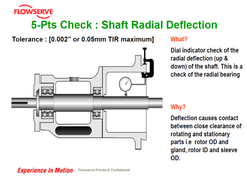

Greeting everyone.
Before do any mechanical seal installation, there are steps that need to be followed. One of the step is to check radial movement of shaft or shaft deflection. How are we gonna do this check on between bearing pump type?? is this step only applicable for overhung pump only?
Thank you.

Here I attached the guideline from flowserve. For overhung, we have the leverage to lift the shaft in order to get the radial value, but for BB type, I dont think it can. Thats why Im asking.
JJPelin, so for you, you do not consider this is a valid check? It doesnt matter if it is a BB type or overhung??
We found that we were failing this test too often. We would disassemble the bearing housing and find no problem. A new bearing with shaft and housing fits that are within specifications can fail this test. It really tells you nothing.
If you just rebuilt the bearing housing, you know all of these measurements are good. If you are trying to decide if you need to include a bearing replacement when replacing the mechanical seal, it is a poor indicator. Vibration data and history drive this decision, not a lift check.
I do not see any value in this test. And, it will certainly drive you to do extra work and replace bearings that were perfectly fine.
