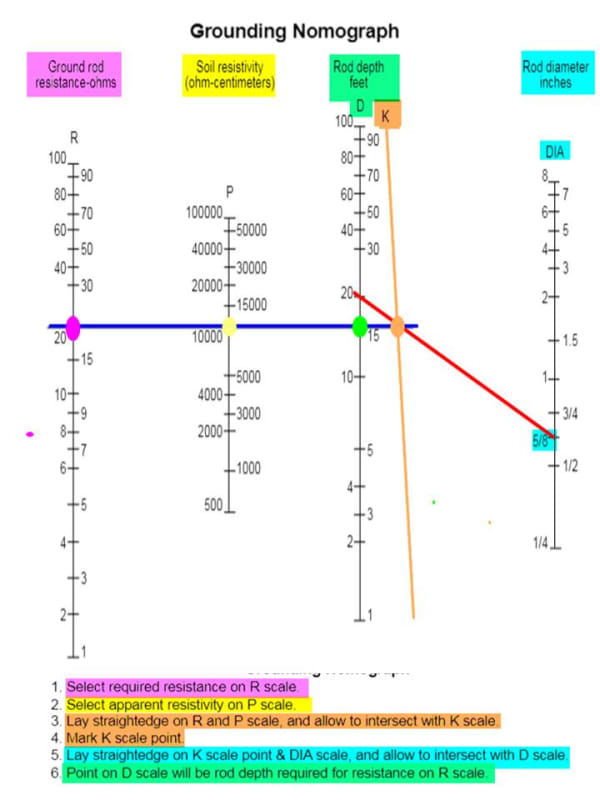

QUESTION 1.b) Distance between the rods of the square-shaped grounding grid can be determined using IEEE- 80?
RESPONSE 1.b) As a rule of thumb, a good practice is to separate the ground rod minimum the length of the embedded rod in the ground. See the nomograph below could help.
