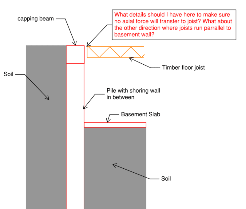

I have situation where I either use timber diaphragm as restraint for my basement walls (option 1) or design as cantilever basement walls (option 2).
Basement is 3m high and I am getting about 20kN/m lateral load at top which will apply to the timber floor if option 1 is used. I have found similar topic been discussed here and I tend to not go for option 1 unless someone can tell me this will work...
For option 2, my question is, how do I make sure that no compression will go to my timber floor. What kind of connection do I need here? Something similar to slotted holes?
Thanks.

Thanks jerseyshore,
It is a new structure. Piles and shoring walls will be constructed first and then timber floor comes after.
I know there were discussions about using the timber floor as basement walls here previously. The main concern is the axial force applied to timber floor joists or sheathing. (
So instead of using timber floor as restraint, I am thinking of designing the basement walls as permanent cantilever walls, assuming no axial forces go to timber floor. Just wondering how details should be done to insure this.
Also, since the floor joist will be designed by contractor, I also want to avoid complicating the design (especially the connection to sheathing) by providing them the axial forces.

That's why I am concerning. I would expect axial force will go to floor joists
But that means it is a cantilever wall system, which is the option 2. I still don't know how the above details can be done.
