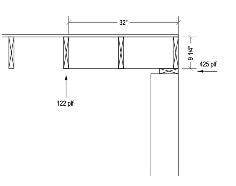

A few bays of blocking ain't gonna cut it with any significant amount of backfill. Do a free-body diagram on your blocks and see.
I agree w/ jayrod regarding bearing. The messy thing for me is when the joists are parallel to the wall. In that case I use blocking for a couple of spaces between the joists to transfer the reaction from the top of the wall into the diaphragm.

Here is 8 ft. of backfill, 8 ft wall @ 40 PSF/FT, 2 bays of blocking using 2x10's
122 PLF uplift at joist where blocking ends. Most of y'all use I-joists IIRC, so the uplift will be worse due to the increased depth of the framing.
Anyone design for this load? Probably not. I have seen this be an issue once in house. The floor was pretty humped up.
