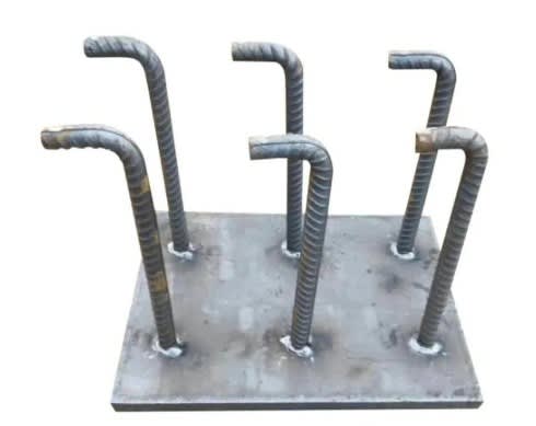

Hi everyone,
I'm working on my first independent structural engineering job right after university. I have to design a 2-story steel house, using tubular sections for the columns and IPE sections for the beams. Initially, I was thinking of designing the base plate with 4 anchor rods, as I was taught in university. However, because we are using steel framing in the house, I'm forced to use a solution like the one in the picture, with hooked smooth bars. The architects told me that they use this solution often in houses, but I'm a little bit worried about how I should calculate the moment resistance of the insert. I'm thinking of using the classic resistance Mn for a beam and using the development length to estimate the length of the rebar.
I don't know if that is the right approach for designing that kind of insert, or if you suggest using another solution for the base plate. I also don't know if I should consider the base plate fixed in both directions depending on the distance between the inserts.
Excuse my English; it's not my first language, and it's a little bit rusty.
I'd never used hook smooth bars... always deformed and also weldable. If you are actually developing a moment, I'd consider using headed studs. I assume you cannot use normal anchor rods and nuts?
The size of the base plate ( 150X150 mm) and thickness( 8 mm) implies that ,this connection could be simple base connection having limited moment resistance.
You may calculate the resistance of base plate with basic principles as you have stated.
AFAIK , the use of plain bars is forgotten and many codes prohibit their use in RC and allow their use only for transverse
spirals, stirrups, and ties smaller than 10 mm in diameter.
I do not have any idea for the code applicable in your zone and will suggest you to look your codes and if the plain bar is allowed , model the structure with pinned end columns .
P.S. = The lap length 45Φ seems a little bit less , i remember 50Φ .

I didn't know that HTURKAK... I've never used them for any projects, nor have I seen them used. Most steel codes still use smooth 'J' or 'L' bars for anchor rods, which I haven't used on any of my projects for 3 decades. I use headed anchor rods, for all my work.
Hooked smooth anchor bolts were discouraged by AISC a long time ago. I think the concrete crushes at the front and back of the hook part and then slips out if I remember correctly. I wouldn't use those in moment or tension resisting conditions.
I haven't used them for decades. I design connections for steel fabricators and about 90% of those I encounter still use 'J' or 'L' type anchors... I don't like A307... but like F1554 Grade 55 S1. These are a lot stronger for little added cost... and weldable. If headed rods are spec'd they are usually A307... I have the EOR confirm my alternative (so I don't take ownership of the alternative). Been using them, almost forever... When I first encountered headed anchor rods, and found out they were much stronger and more predictable; I immediately switched and haven't gone back.
As far as is remember , ACI prohibited the use of plain reinf. bar at mid 70's. Regarding previous practice, i found the following page from the book Foundations of structures ( C. DUNHAM , 1960 )
I agree with haynewp (Structural) and i refrained in moment or tension resisting conditions.

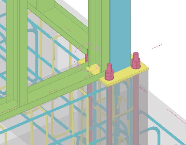

Dik, we could use anchor rods and nuts, but they should be embedded in the concrete because of the steel framing positioning (see Picture 1). I don't know if leveling them in concrete is an easy task; I would assume it's easier to level from the base plate, but I admit my ignorance on that matter.

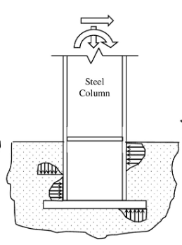

Maybe I can consider the solution in Picture 2 (with weldable rebar), but I don't know if it's suitable for a highly seismic region. The challenge is to hide it or ensure it doesn't interfere with the steel framing above.
Check with your locals... it's done all the time here... likely 95% of all projects or more (I don't know the numbers, just a WAG, but anchor rods are used in nearly all projects sitting on 1" grout (or thereabouts). [correction] A lot of the projects, in this area, still use 'L', and 'J' bolts but with threaded nuts for attaching the column. It's generally less costly to install a column with bolts than to have the crane 'hang around' supporting the column for it to be welded.
dvd... haven't checked the sheet in detail, but it is an excellent sheet.
Thanks, I've sealed connections on projects within the last few days that use smooth A307 'L' bars (20"long, 3" hook and threaded 4" end)... It's not prohibited in these environs, and is still common.
a) is still common, and I add a caution about using jam nuts.

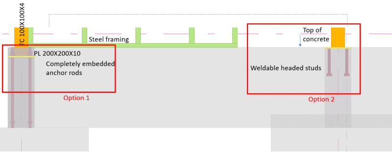

I'm currently considering these two options. I believe that when the column is embedded, it will bear against the concrete, and the free body diagram (FBD) will change, affecting the design methodology.
Option 1, provide a pocket for the column... that's often done in these environs. Option 2 with headed studs if you really want to weld the column... both totally feasible.
I would rely on the anchor rods/headed studs for providing the moment resistance. I would not rely on the column bearing on the concrete. Base plate may have to increase in thickness. Pocket may be 3" deep.
I've done both of those before, prefer Option 1 since you can provide leveling grout under the plate for tolerances.
trickier with headed studs... have to level in place. One of the reasons for Option 1.
