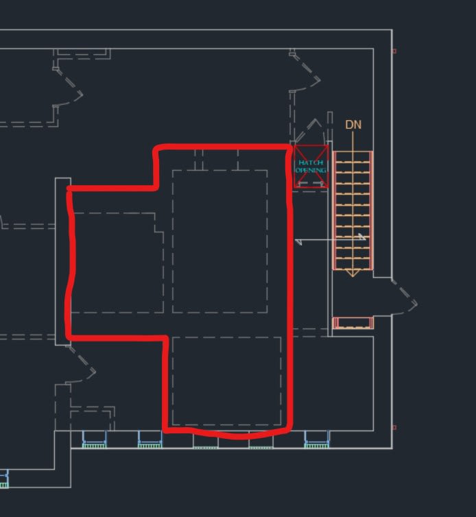

Here's a plan view:
Image#1. 1st floor plan. Red line is the extents of the vault. Dividing dashed lines are concrete walls. I'm wondering if the bottom portion of the vault is a later on addition.

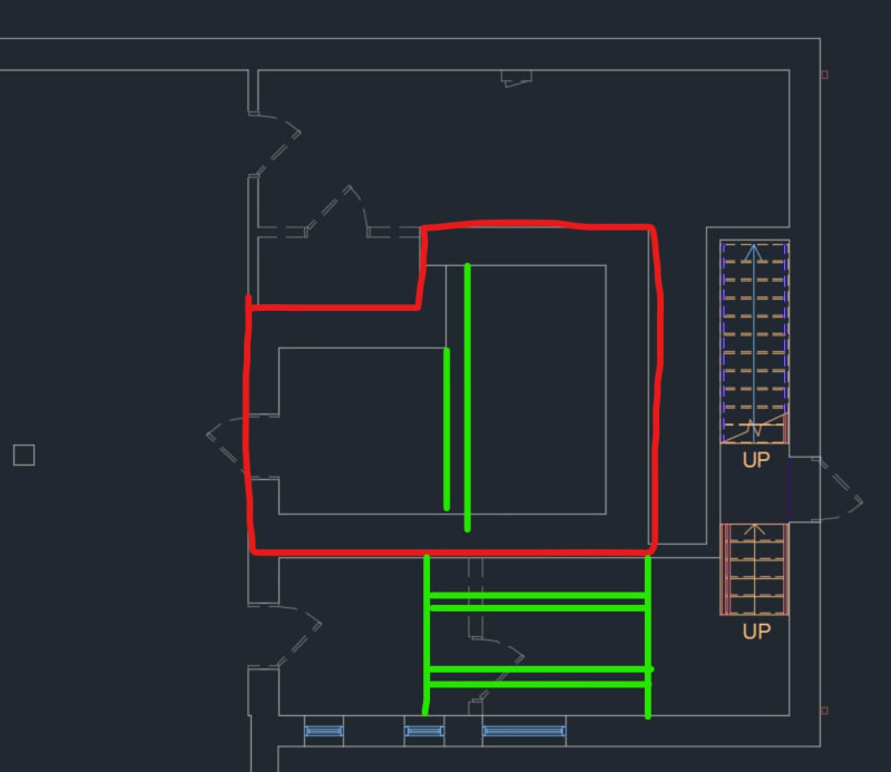

Image #2. Basement Plan. Red line is extent of vault. Green lines are the dropped beams and the extent of the thickened slab in the above pictures.
Looks to me like the beams are supported by the block wall and cantilevered into the space pictured.

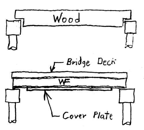

Maybe the concrete slab is strong enough to span that short distance, but since the corridor is 20ft long, the drop beams, while unsupported, make it stiff enough so it doesn't dip in the long span direction? Does it work like that?
Yes, it can work like... just as it works for notched wood beams and steel bridge girders with bottom flange cover plates (the top flange being continuously braced by the bridge deck). The concrete dropped beams increase moment of inertia to reduce both bending stress and deflection.
At that time, 1900's, wood, steel, and reinforced concrete were all designed by somewhat similar versions of what we would call "Allowable Stress Design". Using unsupported concrete dropped beams to increase moment of inertia would have seemed completely logical to engineers then.
