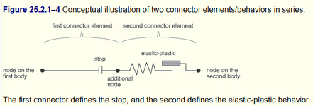

I would like to use two axial connectors in series. One will be a stop connector and one will be elastic. In fact, it's nearly exactly what's pictured in the manual (without the plasticity): 1740773940305.png
I am using this in compression (rather, I would like to). I have not been able to successfully keep the three nodes colinear. The mid-span node acts as a balljoint. I've tried kinematic coupling contraints though I'm foggy on their proper application. I've tried eliminating the rotational degree of freedom using an equation constraint and I've tried just applying a BC to the central node (constrain rotation DOF). For some reason I've only found scant information on this application online. In the ABAQUS user community I found a connector powerpoint that acknowledged that you risk creating unwanted balljoints, but the fix was not described in a way that I followed. I'm using CAE / ABQ 2022. Thank you.
why would you not use a beam element for the right hand part with non-linear material properties?
Thanks for the reply. Yes, I suppose that I could use a beam or a spring with non-linear properties to serve in a similar fashion. I remain hopeful that I can use connector elements in series just like they picture in the manual. I like the idea of being able to stack the components together to get what I need. It would be super convenient if only I could get past the issue of how to properly constrain the middle node to allow the assembly to handle compression. Thanks again.
Can you share the .inp or .cae file with the model in which there’s this undesirable behavior without constraints applied to the middle node ?
Hi. Thanks for the response. The original model was pretty large so I tried to whittle it down to a couple of representative pieces. That didn't go as smoothly as I had hoped... Anyhow, the attached input deck shows some of the behavior that I'm fighting; it might be helpful to dial up the displacement magnification to see the center connector node go out of line. To be honest, it's not behaving like I had hoped in other aspects as well. I would expect to see some stresses develop in the "block" component of the assembly at the application point of the connector. Are there any pointers for a rock solid step-by-step connector recipe out there? "top dog engineer" has a good youtube video where he's using connectors as bolts, but I'd really value a more general tutorial. I feel like I go down a rabbit hole using CAE to create connectors; as I iterate I end up with unused wire features, RPs, etc. It just turns into a real mess. I might be well served to update from ABQ22 though I couldn't say if they've worked on the connector tools or not. I look forward to your input and thanks very much! Regards.
