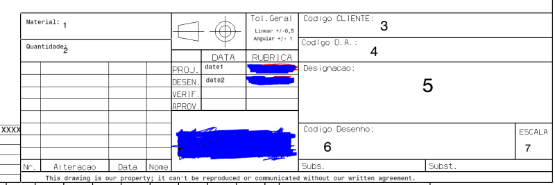

Hello everyone ! my name is Andre. Im an IT student internshipping in a metal design factory working for the first time with Catia.
I'm working using Catia v5r26.
So here they have a custom title block someone made, and they use it for all the parts.
The thing is they have it in a CATdrawing, each time they need it they create a copy of the file and delete the previous part views and data. And they fill the gaps with the new information by hand.
I'm trying to find a way to have the custom title block in a macro or by someway that would be more easily acessible. And fill the gaps such as date, number part, material and Designer automatically (getting that information from the part itself).
1 - Would there be a way to "transfer" the custom title block they have into code ? or do i need to draw it all over again ? I don't have much experience creating tables and its not simple, it has different column and row width, an image...
2 - Can I get that automated filling of the gaps using only formulas ? or is macro necessary too ?
I've searched but haven't found a thing like this. However if you can send me links or something I appreciate :D

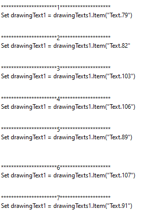

... but I cannot seem to identify a text-item by its' name reference "xxx", only by item number?...
regards,
LWolf
LWolf with the code I posted above I can get to the value of the text box, by searching it in the drawing and changing it to something else. What I'm not able to do is select the text box itself to change what's inside it. Till now with no success.
The number inside doesn't serve any purpose, merely to enumerate the boxes. The boxes names go like Text_01 ...

I've tested with CATScript too and it puts out another error :
It says Incorrect type : 'view.Texts.Item'
Here's a sample of my code for changing titleblock text boxes (in sheet background). This is used on a userform so some strings refer to clickable buttons or text boxes there.
Code:
Dim DrawingDoc As DrawingDocument
Set DrawingDoc = CATIA.ActiveDocument
Dim TitleBlockTexts As DrawingTexts
Set TitleBlockTexts = DrawingDoc.sheets.ActiveSheet.views.Item("Background View").Texts
Dim Weight
Set Weight = TitleBlockTexts.GetItem("TitleBlock_Text_Estimated_Weight")
[COLOR=#73D216]'.... code for other unrelated functions[/color]
If WeightApplyAll.Value = False Then [COLOR=#73D216]'disregard the If...Then I have an "apply to all sheets" toggle button on my userform[/color]
Weight.Text = UCase(Title_Block.Weight_TB.Value) & " " & LCase(Weight_Unit_LBL)  [COLOR=#73D216]'"Weight_Unit_LBL" is for a kg/g option on my userform[/color]
End If
yupp, GetItem does the trick! thx
