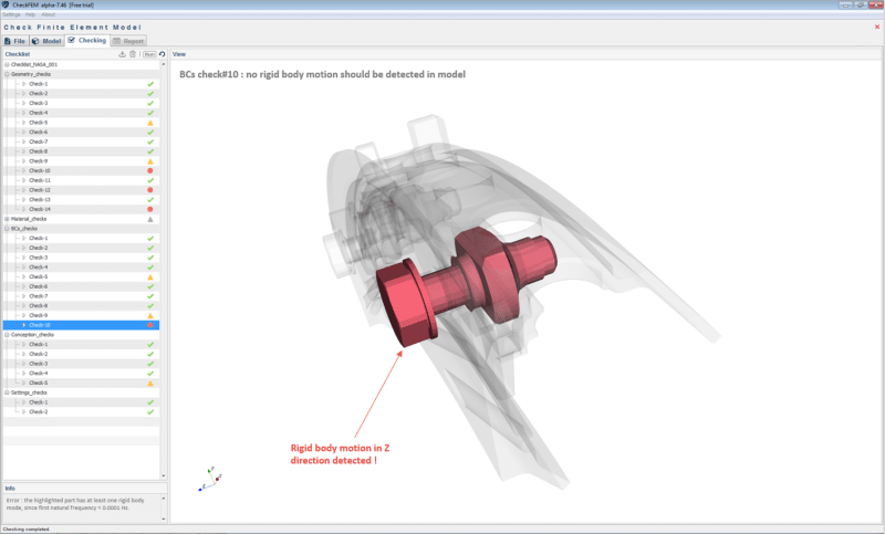

Hello everyone,
According to this post --> thread507-321928, I am no the only one suffering from quality control of finite element models [cry]
I work in a company (aerospace) where I have to check calculations/results of the team .. this gives me a lot of headache [banghead]
A couple years ago, I started developing (with friends) a desktop software to overcome this particular task: the software must read the input file (bulk data), execute a checklist, and display result of the check.
Simple to say, but not easy to do .. the work still going .. I am alone in the project now (friends gave up)
What do you think about this solution ? Is it worth to continue ?

Some of our customers use Abaqus, others use Samcef, Ansys and sometimes Nastran. My goal is to be able to analyze any bulk data format and see it as a finite element model: mesh + BCS + loads + properties .. and finally perform consistency checks.
Currently, I am analyzing the Samcef format since my main client is using it.
The software is not ready yet .. but I am targeting checks like:
- dimensions of the FEA model in relation to the actual dimensions of the part
- mass of parts
- Are the properties of the materials correct and assigned to the appropriate model parts?
- quality of the mesh
- are the loads and constraints applied accurate
- tests of free thermal expansion and rigid body movement
- ..etc.
I want to be able to do all the checks in one click!
This is a view of the GUI:

Interesting point RandomTaskkk ! can we let it be an open source project ?
By the way, the aim of this tool is to check for human mistakes when setting up input data .. checks should have parameters editable by the user to meat company rules ..

Let me clarify one thing: checking a finite element model is a time-consuming, repetitive, boring and painful task. A senior engineer spending his days extracting fields from finite element models to check if the right property was used, if the units are consistent, if there is no negative pressure .. etc, it's a shame to waste time doing that. My purpose is to provide the experienced engineer (usually responsible for checking young engineers work) with a tool which -for each well known check- will:
1- gather necessary data form model,
2- perform the check if possible, if not, display only necessary data for the controller to make the right decision easily
The checklist should be prepared/selected by the experienced engineer. Doing the checks is a job of robots .. not humans!
to L_K (Do the calculation software have an option to open models in read-only mode without license?) --> no need for any license, since the software will read the ASCII input file, parse it to reverse-engineer the model in order to run a checklist.
Remark: I do not pretend that this approach will catch all kinds of mistakes/errors in a finite element model. What I target is input data errors. I would like to be absolutely sure that the data used by the calculation are exactly the agreed data. The interpretation of these data and the results they give is another matter.

To Agent666: your are right, and this is why this tool must have a 3D viewer to clearly display the model components concerned by the check..so the human checker can control/validate it.
