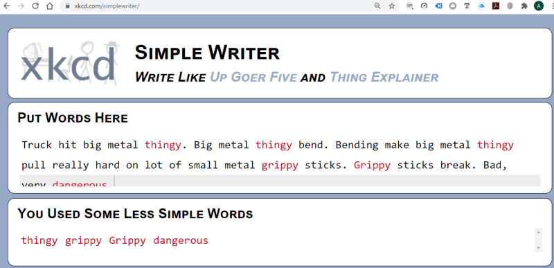

Truck hit big metal thingy. Big metal thingy bend. Bending make big metal thingy pull really hard on lot of small metal grippy sticks. Grippy sticks break. Bad, very dangerous.

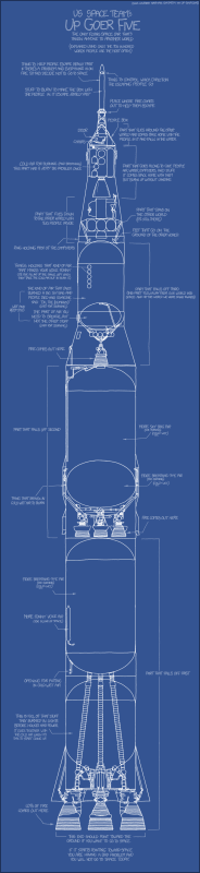

That was the first thing I though of when I read that sentence. For those who haven't seen it. Here is the blueprint for the Saturn 5 Rocket, otherwise known as the Up Goer Five.
