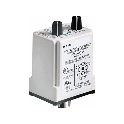

Voltage monitoring relays
Simple and effective monitoring
Eaton’s voltage monitoring relays are solid-state protective relays that automatically operate when one or more phases of the three-phase supply is lost, or when the phase sequence is reversed. These relays monitor three-phase voltage and respond to abnormal or overcharge conditions, a pre-selected undervoltage threshold and a pre-selected percent of phase imbalance to protect equipment against voltage fault conditions.
Link
One of these for the mains and a second for the generator side.
Add a couple of timers or a PLC and you're good.
I would used purpose built voltage monitoring modules even with a PLC.
