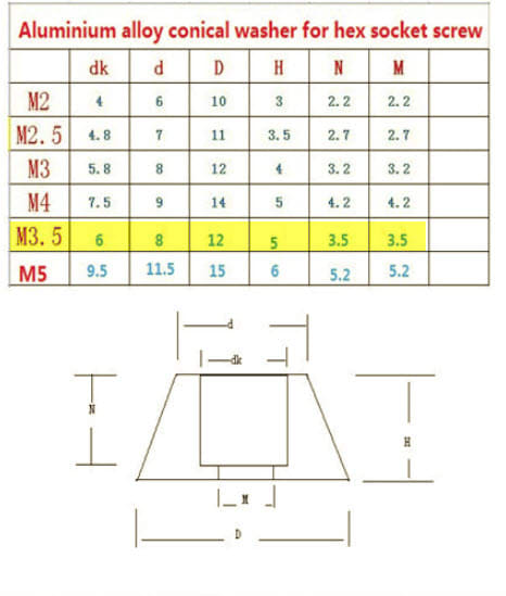

In a couple early prototypes using 30 degree bends, when pulling multiple cables around a horizontal direction change, it was possible that one or more cables would be less taught than others and fall into the gap. This is exacerbated by the fact that the pull is not constant, it's a lot of pull - relax - pull type of thing. To solve that with the 30 degree Z, I could pop rivet cone washers to block the gap, but that's one more step. If I could make the 90 degree Z work, that'd be ideal.

Conical washers i was considering with the 30 degree bends
just for FYI
