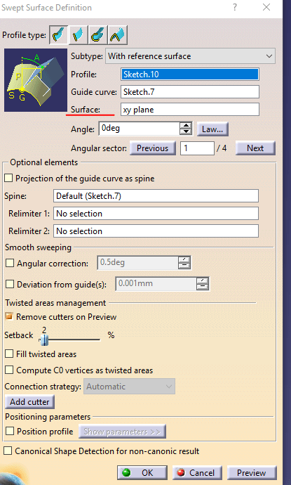

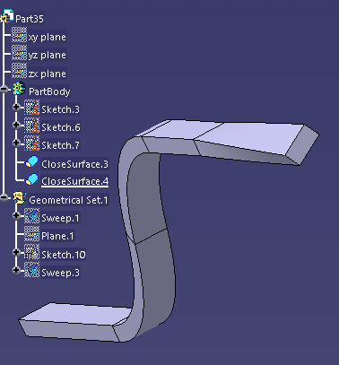

So I have managed to make solid from two closed, swept surfaces:
As I understand, those two CloseSurfaces are one solid PartBody now? I don't have to make some strange boolean or joining operations.
I also do not fully understand the effect of "Surface" reference (from geometrical point of view).
When I am choosing the same plane where a profile was sketched, error:
When I am choosing one of two other original part planes, the effect is the same, I cannot get what information we are giving by choosing reference surface.
Merci beaucoup again. Anyhow, the first problem (sketch edges not visible in Part Design workbench) is still not solved :D

reference surface/plane is where you measure the angle from. Try this: Choose linear sweep with reference surface. You have your guide curve, and as your profile make a line which is normal to the guide curve (starting at one of the guide curve's ends). say your guide curve is in the xy-plane--choose xy-plane as support. in Law for the angle, choose linear type, start 0; end 3600 :) see what happens :)O
