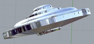

Thank you for your response.
I made a 2D drawing in autocad of the perimeter of that surface, I then imported it into
Solidworks and revolved it to 36 degrees. My object here is to assemble 10 36 degree wedges to form a complete circle
as the image I have attached.
I would think that the surface would be flat.
